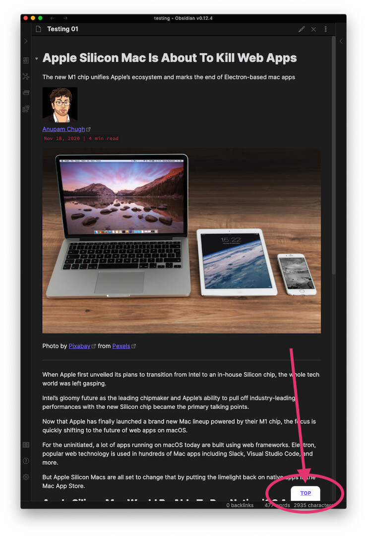

Hi all. I try to add a small <span> element in order to make a “Back to top” button for long content pages. But after working with most of my pages, I found there’s a situation here: in some of the longer pages, the button would disappear until I scroll down to some point of that page. Am not sure if this is a bug or not, see if anyone can point me a fix or direction here…
My simple code is here:
  1. I add this at top of the page: ^Top
  2. then I add this to the bottom of the page:

  1. As the 2 GIFs showing below, the “TOP” button would appear normally at the right bottom of the page. But then if I add more content to the page, the “TOP” button wouldn’t show up, until I scroll down to a certain point of that page.
TOP appear
TOP disappear
