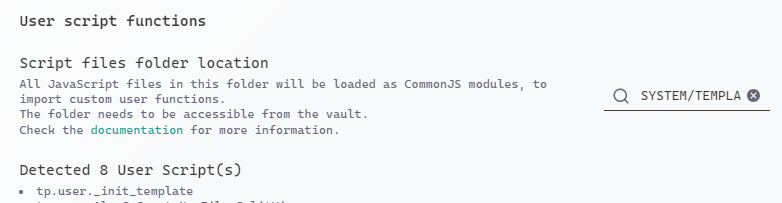

Save this script as getAliases.js and place it in the user scripts folder of your choice (of Templater):
Templater will automatically see it, but there is a refresh button you can press as well if you had your Obsidian open when you added the script in your file explorer.
There are options at the top of the script you can modify:
