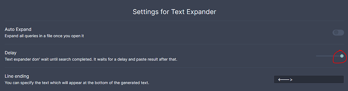

This search takes more to compute. So I’ve extended the plugin’s delay confi as much as it allows:
