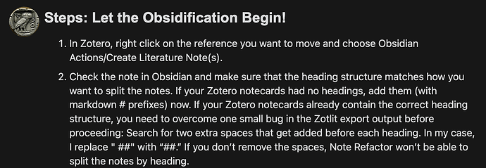

Steps: Let the Obsidification Begin!
  1. In Zotero, right click on the reference you want to move and choose Obsidian Actions/Create Literature Note(s).
  2. Check the note in Obsidian and make sure that the heading structure matches how you want to split the notes. If your Zotero notecards had no headings, add them (with markdown # prefixes) now. If your Zotero notecards already contain the correct heading structure, you need to overcome one small bug in the Zotlit export output before proceeding: Search for two extra spaces that get added before each heading. In my case, I replace " ##" with “##.” If you don’t remove the spaces, Note Refactor won’t be able to split the notes by heading.
  3. Sort by heading with the Sort & Permute plugin. This is to overcome another small bug in Zotlit, which currently spits out notes in a seemingly random order. You might not care about this, but I’m OCD enough to find it annoying that the note order doesn’t match the one I created in Zotero, even if the links all still work.
  4. Use Note Refactor to split the long note by heading.
