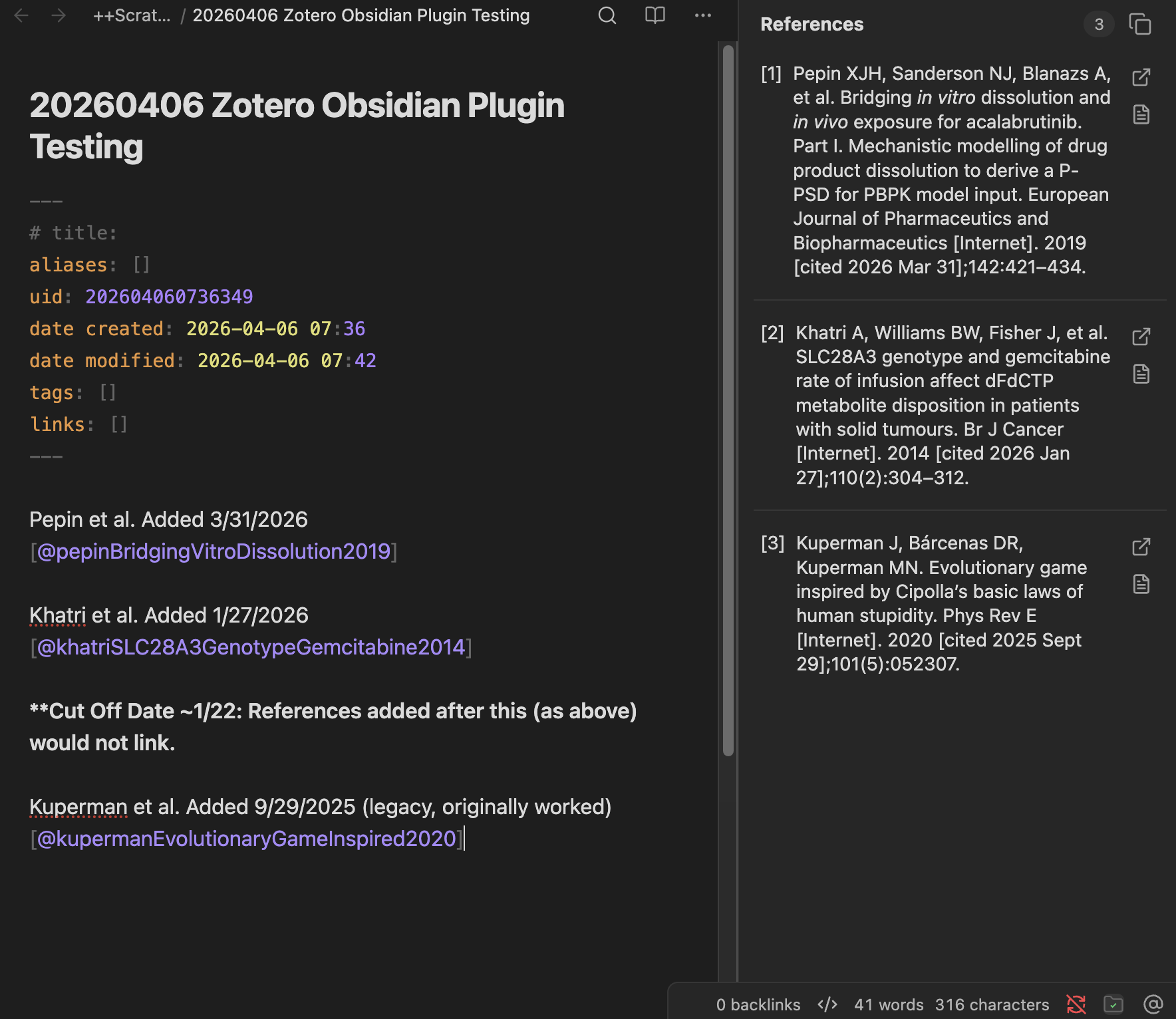

I was using Zotero Integration plugin for a very long time, and it simply doesn’t work anymore. Strangely, it only stopped working with Zotero references I added to my Zotero DB after say Jan 23 2026. It seems to work with any references entered before that rough date.

Thanks for the quick reply. Like I said, I found about three other threads where people had similar problems, and followed the instructions that fixed it for them, with no luck. I have no idea what changes or settings could have affected this. I’ve auto-updated Obsidian several times, have been running Zotero 8 the entire time, and I just refreshed the Better BibTex Zotero plugin thinking that might help - it didn’t. I don’t even know where to look at the logs - would those be Zotero or Obsidian logs? Running Zotero v 8.0.2-beta.5+c35d7f21e, Obsidian Version 1.12.7, Zotero Integration 3.2.1, Better BibTex 9.0.10, all on Mac environment. It probably has something to do with the citation keys or an update to Zotero where they handle these differently. Because it works for all my old references, just not ones added to my Zotero DB after Jan 23. If you could point me to log locations or have any other ideas, I’d appreciate it.

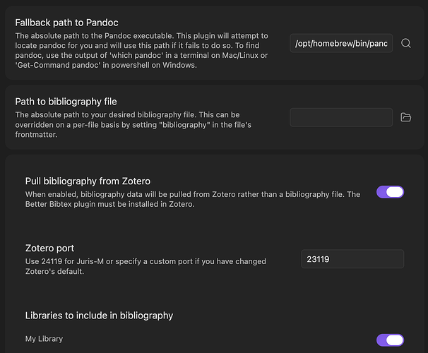

  • I am using Zotero Integration plugin with both Pandoc, and another plugin called Pandoc Reference List (PRL). This may be part of the problem - PRL doesn’t seem to want to pull the bibliography from Zotero anymore in real time. I hacked this by manually exporting my full Zotero library to a separate .bib file, pointed this plugin to that file, and my problem was solved. This might be a workaround.
  • Strangely after all of this, I went back and tested for the issue, and it all seems resolved! Even after I redirect the Pandoc Reference List plugin back to Zotero, and “delete” (read- move) my hacked exported bib file.

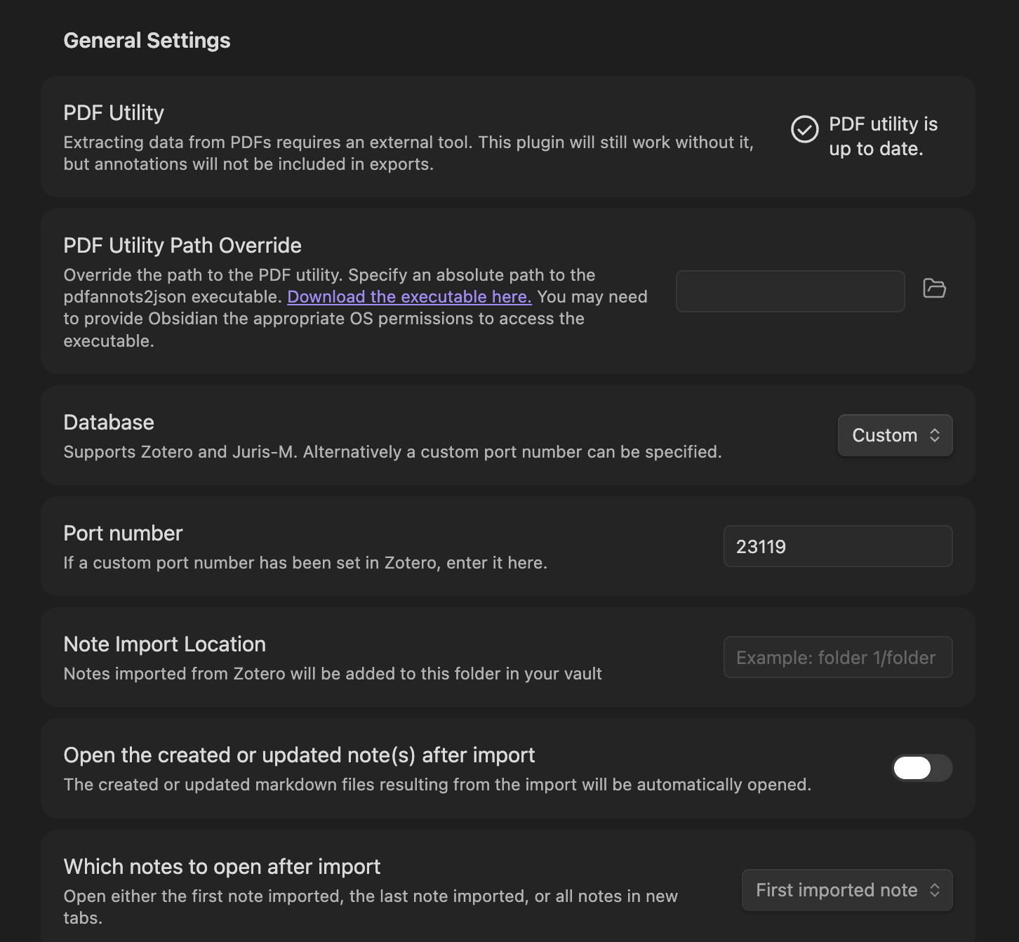

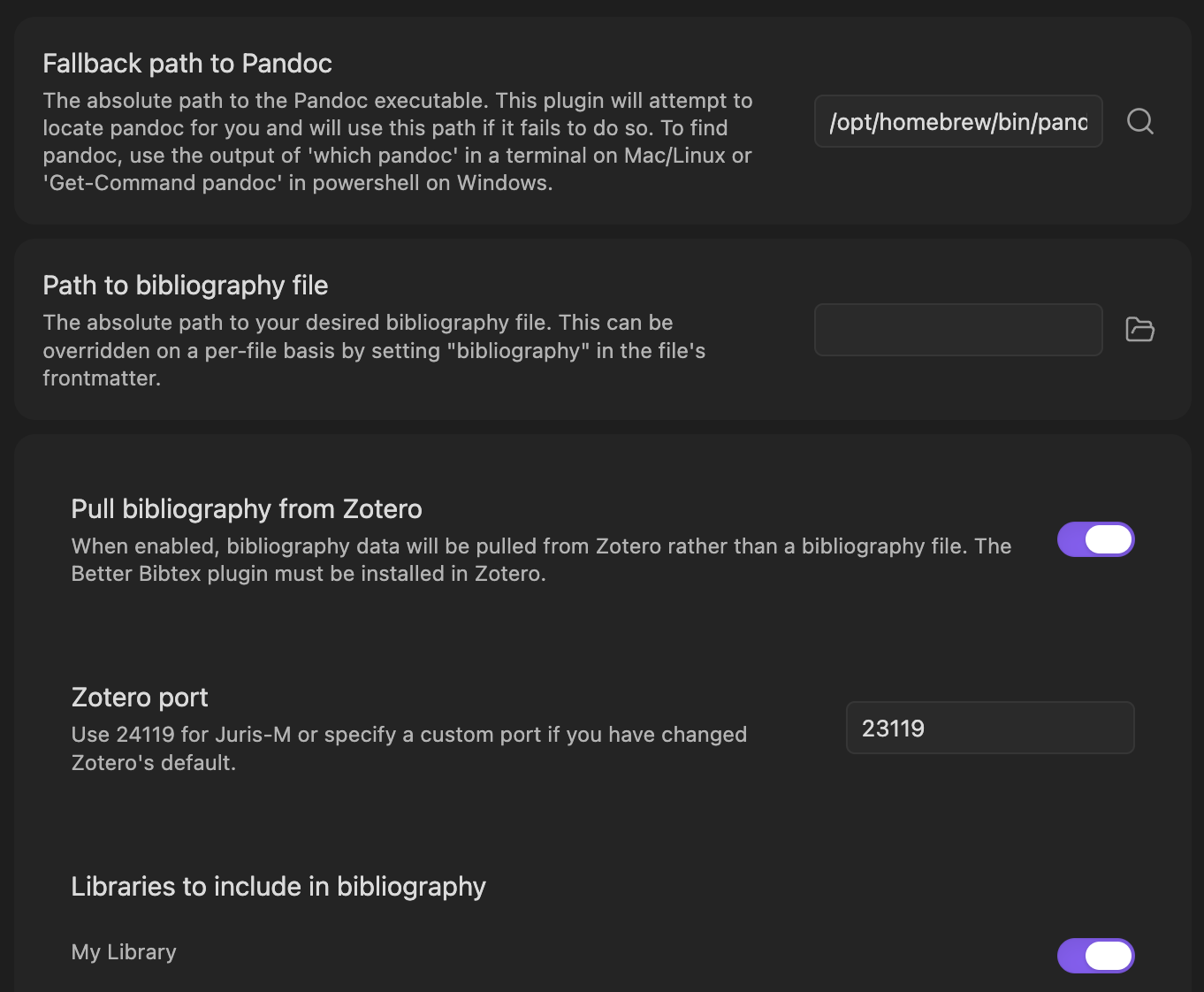

Current Working Settings
Zotero
  • macOS 26.4, Zotero 7.0.32, Better BibTex plugin 7.0.76
  • Zotero API out of port 23119
