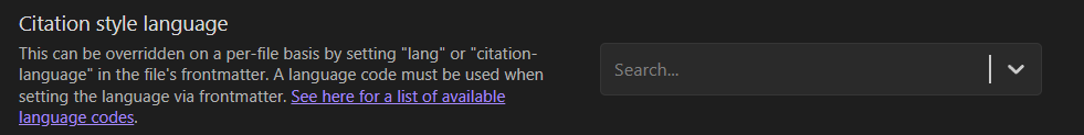

Doing this, it uses “p.” again and ignores my language settings. I have set Zotero to German in the export tab, and I also set the Pandoc citation style language to German.

Have you set the citation style language locale in Pandoc Reference List’s settings?
Was that you were referring to here?
If so, did you use the right locale code, de-DE?

I had the settings applied like you suggested. Sadly it doesn’t fix the problem, but your tip with autocomplete is a nice workaround for that, thank you :slight_smile:
But you have Deutsch (Deutschland) in your screenshot, not de-DE as I suggested. Have you tried the latter? (edit: Nevermind, I see now that the codes are just for the frontmatter specification option, the settings are predefined options).
It would also be helpful to try the frontmatter method mentioned in the settings.
