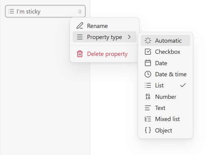

When `Delete property` doesn't delete
If an unused property sticks around you press Delete property, it’s likely because the manually-set property type is still saved in the settings json. To remove it, right-click the property again and this time choose Property type > Automatic.

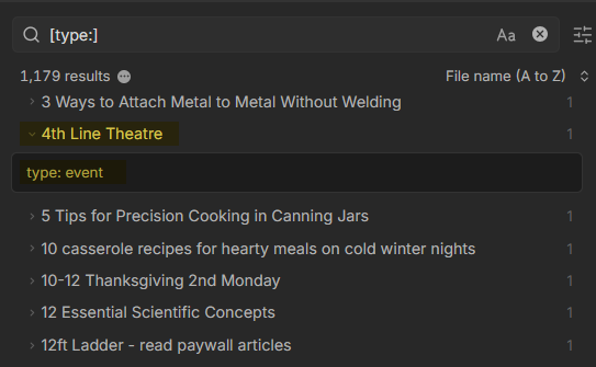

I search for the property type. There are over 1,000 results.
I can’t just auto rename it something because I’m not sure how I used it. To see how it is being used I have to open (expand) each of the 1,000+ files one at a time (unless I’m just not seeing the expand all button)

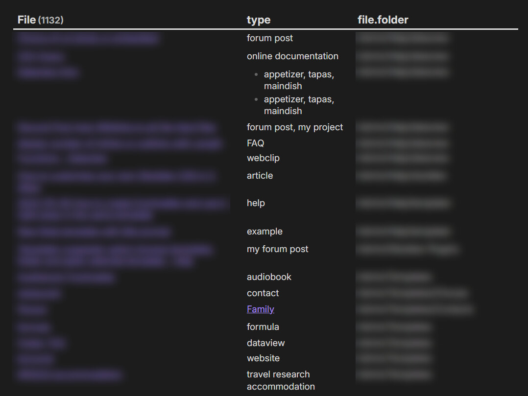

What I CAN do is create a dataview table, displaying the value (a SINGLE value) and the file folder which will also give me some context:
Now I can see that I used type for too many different things. Given that I want to re-create my templates with lots of suggesters, I’d like to get an idea of what I might use type for in the future (or ditch it), and what I should do with the values I no longer think should be associated with it.

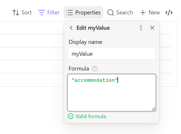

Your follow-up explanation helped a lot. I think this simpler base might help once you’ve identified a repeated value:
formulas:
  findEmAll: file.properties.filter(if(value.isType("string"), value == formula.myValue, if(value.isType("list"), value.contains(formula.myValue)))).keys()
  myValue: '"accommodation"'

In the property formula called myValue, replace the word accommodation with whatever single value you’re looking for throughout your properties.
The findEmAll column will show you the name of the property that contains the value.
You could then display the relevant property columns in order to directly edit them.
