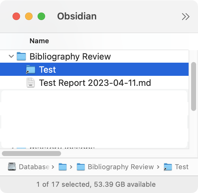

This example uses a folder called Bibliography Review. You may use whatever folder you want. Move the above created symlink for the Attachments folder or sub-folder from Bookends into your chosen Obsidian database folder. Remove the symlink suffix.

Run the menu File-> Save PDF Annotations to save report to the top level in the folder created in Obsidian (Bibliography Review). Assure that the file has the extension .md (for markdown).
Reviewing the Report in Obsidian
Open Obsidian. You should see the top folder (Bibliography Report) containing the report and attachments folder. In view mode, the report should show the active PDF files. By its delivery through symlinks, the PDF files are actually contained within your Bookends attachments folder or sub-folder.

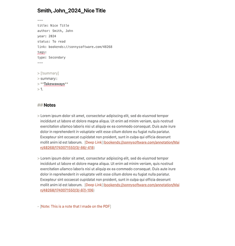

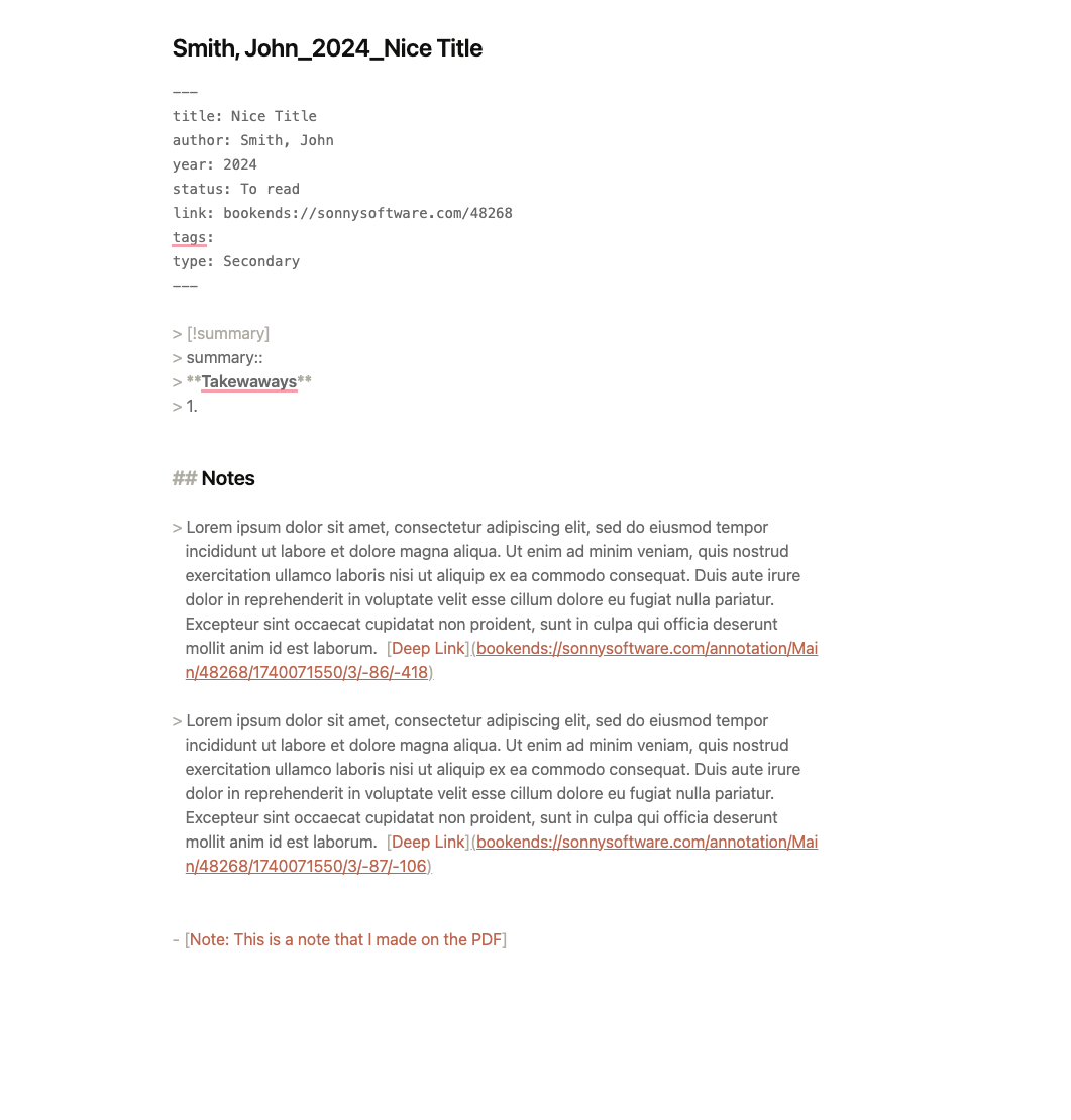

I wanted to share a somewhat similar workflow that I created using Shorcuts. This one also extracts the notes from a reference and saves them as a note in a specified folder in Obsidian. It does the work of naming and setting the contents of the note in Shortcuts itself, using a mix of Shortcuts actions and applescript, which I found gave me a lot more flexibility. It doesn’t embed the PDF. It’s a little clunky at times and can probably be streamlined, but it works.
Here’s the shortcut: Shortcuts
In the middle it runs another shortcut that helps clean up the notes in a format that is much nicer. Here’s a link to that one: Shortcuts
The resulting note looks something like this (shown in source mode)

This looks really useful and I’m trying it out. I’m not too familiar with Shortcuts, so it’s a bit of a learning curve. Is there a way to get the citation key as well?
The Bookends code for citation key is u1. Using the Workflow approach that I posted, add u1 to the Bookends format to export. Using the Shortcuts approach, you probably need to insert a directive to tell Bookends to “set theCiteKey to u1 of theReference” or an equivalent.
