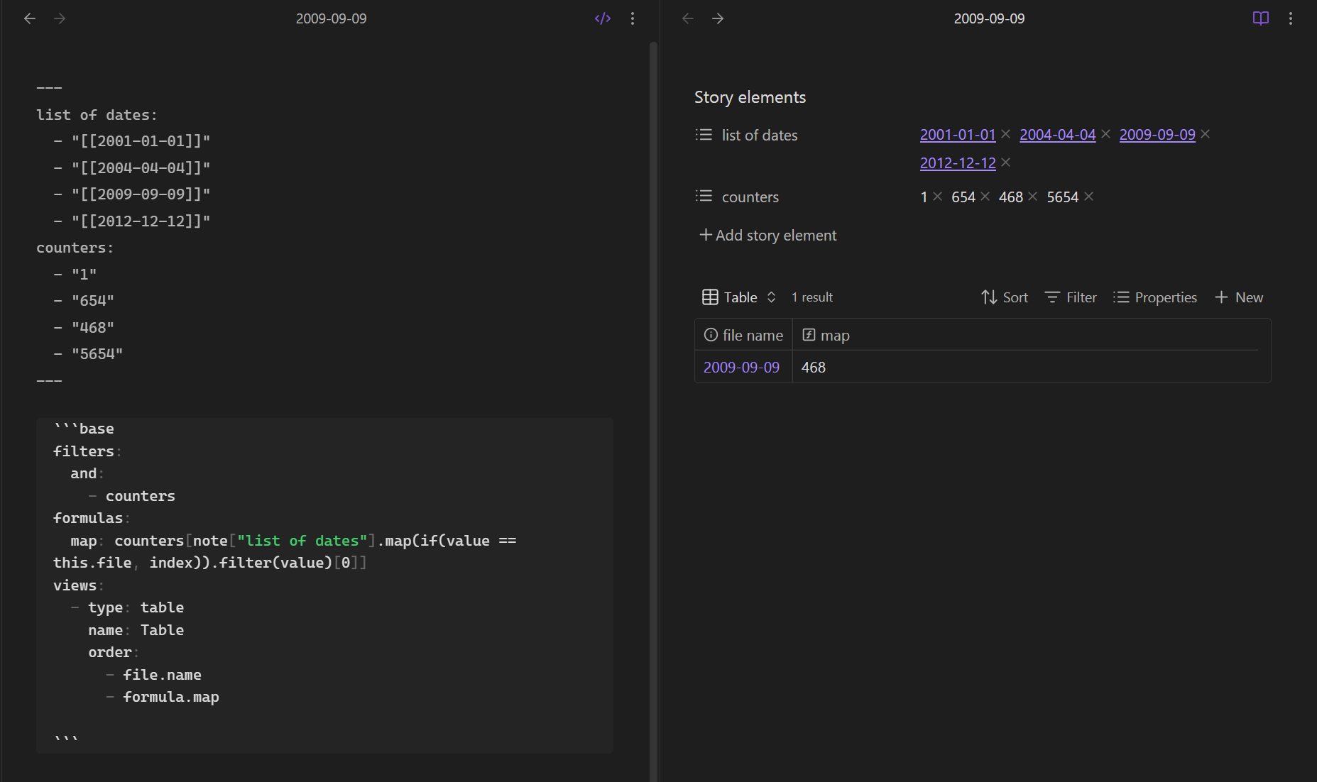

Thank you very much. But Iām sorry I canāt get it to work. Please explain what I am doing wrong.
I simply replaced b with the name of my ācountersā property and replaced a with the name of the list of dates property and replaced āYOUR_SEARCH_VALUEā with this.file.name since the file containing the imbedded base is a daily note.
No results. Any suggestions?
I really donāt understand the way filter(value)[0] works.
Oops, in my screenshot, ignore āStory elementsā where it should say āPropertiesā. I was playing around with that and forgot to change it back.
And I forgot to address:
map maps the values of list a to return the index number when the search term is a match. That leaves a bunch of null values when thereās no a match. Enter filter(value), which filters out the nulls, leaving only the one that has a value (unless you entered the matching date more than one time in the same list). Now it has one value, but itās still a list. So [0] is one of a few ways to turn the list into a string with just its one value. Itās not better than any other way; it was merely the one with least of number of characters that came to mind.
Thereās no need for that kind of replace. this.file.basename does it.
All I can do is keep guessing what you need to fix. If you want more help, probably post your base code and an example of each type of relevant note, including relevant YAML and file name format.
Thank you. My property name doesnāt have a space but probably including a # sign caused the same problem. Wrapping it in [āā¦ā] fixed the āinvalid formulaā problem.
Just in case, I simplified the property names. In a book file they are now:
Oh I see it. My ābrilliant shortcutā of filtering for plain value is returning empty when the matched index is zero. (Iāll edit the original to no one else gets stumped on it.)
Replace .filter(value) with .filter(!value.isEmpty()). This is the whole formula for the note you shared:
