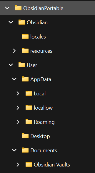

The goal I’m trying to reach is having a fully Portable installation (or “Standalone” installation?). Where Obsidian is fully contained on a Flash Drive. I read somewhere that “Portable” does not negate the necessity of copying some config files on the PC’s local Hard Drive, but that “Standalone” means everything stays in one location, without requiring copying / installing files locally (I’m not sure what I’m saying is 100% accurate).
There is nothing “installed”, per se - the batch file extracts the files out of the installer and places them in the directory structure it creates.
The folder you create doesn’t necessarily need to be on the local drive - “%~dp0User” translates to “.\ThisDirectory\User\.”
Here’s an example of the directory structure where “ThisDirectory” is “ObsidianPortable”, which is where the batch file lives:
For my install, this lives on a second drive within a subfolder, completely outside of my user directory.

Step 5 — Understand the Resulting Folder Structure
After the first run, your ObsidianPortable\ folder will look like this:
ObsidianPortable\
├── ObsidianPortable.bat       ← Your launcher (run this every time)
├── 7z.exe / 7z.dll / etc.    ← 7-Zip files
├── Obsidian\                  ← Obsidian app files (extracted)
│   └── Obsidian.exe
└── User\
    ├── AppData\
    │   └── Roaming\           ← Settings, plugins, themes stored here
    ├── Desktop\
    └── Documents\
        └── Obsidian Vaults\   ← Your vaults live here
Everything — settings, plugins, vaults — stays inside ObsidianPortable\. Nothing touches your Windows user profile.
