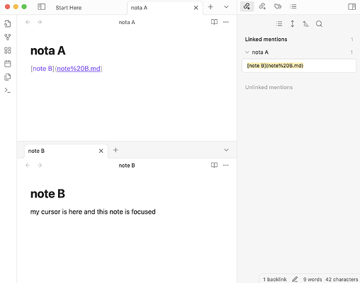

Also, spaces in Markdown links need to be encoded as %20 (mentioned here).
With the Use Wikilinks setting off, Obsidian will take care of this for you if your note has spaces. You can still use [[ and the suggestions for creating links; when you are finished and hit enter/return a Markdown link will be created.
CleanShot 2024-08-19 at 08.47.11
Your understanding of backlinks is correct.
