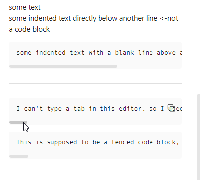

I’ve noticed when I place a leading tab or four spaces before a line, it indents the block similarly to a block quote but without the line on the margin. I had to dig a bit to find that this is officially the Markdown syntax for a code block—I only knew about the backtick syntax for fenced code blocks.
That’s fine, but in the default Obsidian theme, tabbed code blocks only render in live preview—they’re ignored in reading mode. Even in live preview, the font remains the same rather than changing to monospaced. This confuses me.

Those both work correctly here but not in Obsidian—it renders both inline code and fenced code blocks in a monospaced font, and it ignores italic formatting, but it wraps the text. This processor renders the text in a single, scrolling line, which seems more appropriate or accurate.

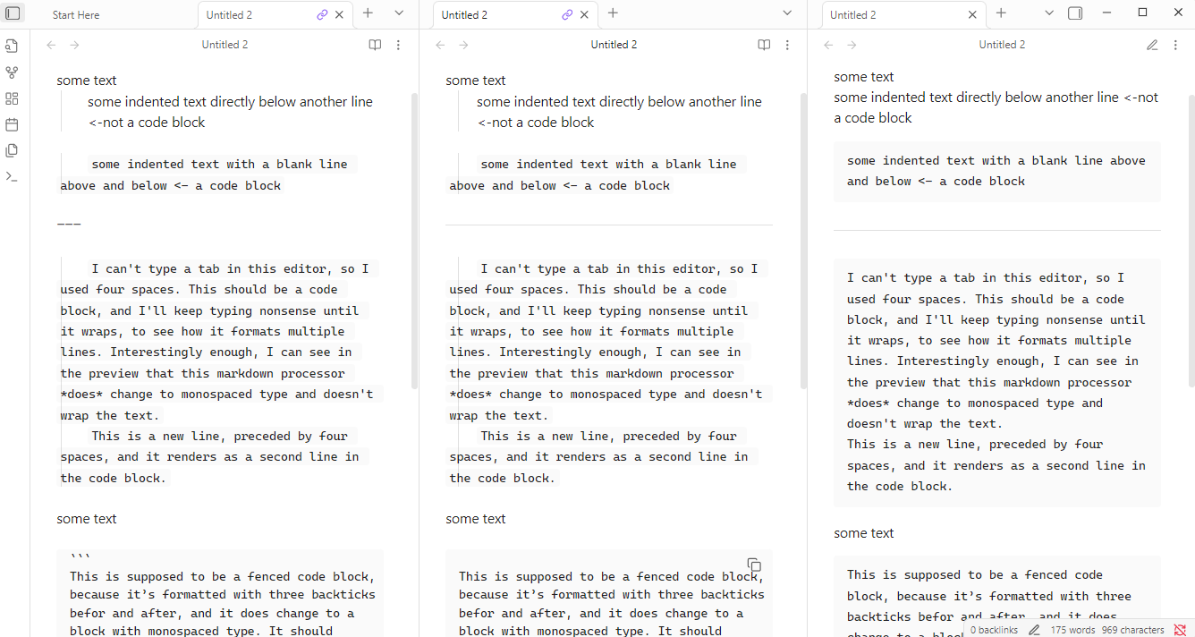

Although looking a bit different, indented/tabbed code blocks should be fine in the editor and Reading view if they are separated by blank lines above and below.
source mode | live preview | reading view
The first section is what usually trips people up; not that the indented text isn’t a code block, but that the indent is removed/vanishes when switching to Reading view, exporting a PDF, etc.

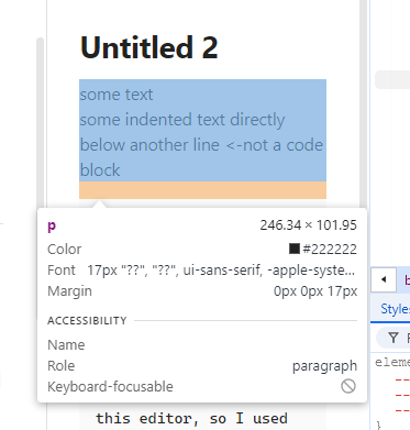

It’s just one big p (paragraph) when rendered:

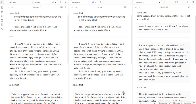

I did have blank lines above and below the code block—you can see my original file here:
If Obsidian (or the theme) doesn’t indent or change the font or turn off wrapping, how is it different from normal text? I guess it respects line breaks, but the default theme doesn’t even respect tabs within the block (I think it respects less than four leading spaces). And if it renders as one big <p> tag, then you could style the block with local CSS. BTW, I had added a .poetry css class to the document, but I confirmed that wasn’t affecting the formatting (I turned off my poetry snippet).

I looked at the original file you attached and apologize if I’m misunderstanding, but I think what you’re looking for can be described by this:
lorem
	ipsum
dolor

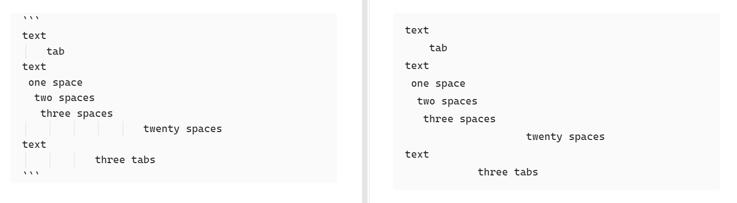

The indentation inside a code block is what’s preserved. Same for other white space.
More visual examples:
text
	tab
text
 one space
  two spaces
   three spaces
                    twenty spaces
text
			three tabs

I just looked at my file again, and you were right—I’d placed a blank line after the code block but not before. I added a blank line before, and bingo! It worked!
