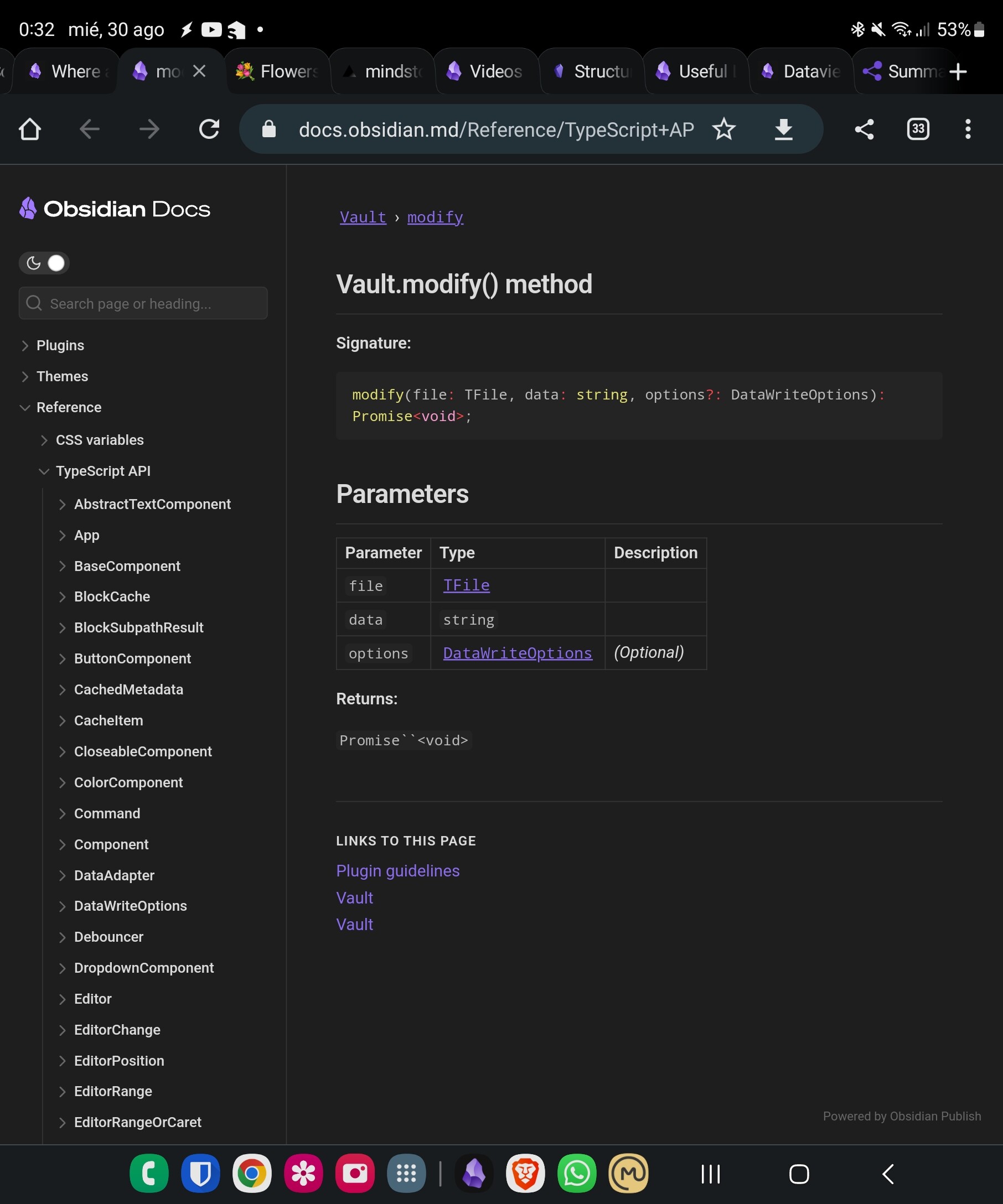

I saw several people saying that developer docs are great, however, other than the example plugin and related guides, the API reference is quite sparse in explanations. To give you an example, the app.vault.modify method doesn’t say a thing about what it does. Yes, it takes a file, a string data, and a third optional argument, but, for what? What does it do?

It has the type DataWriteOptions, which is defined in the d.ts as well.

Yes, I saw it, but that doesn’t change anything. Github type defunitions are still the only source of information and the official API reference docs are useless

The API reference on docs.obsidian.md presently gets compiled from the d.ts., it’s another way to view that file.
