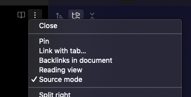

Related to changing the mode, you can either use the icon and the menus in the top right (see first image below), aka the book and the pencil icon, with the corresponding triple-dot menu to enable source mode when in the editing mode. Note that this icon shows which mode you’ll change to, which can be a little confusing. So if you’re in either editing mode, it’s a book to show you can change to reading. And if you’re in reading, it’s a pencil to indicate you can change to an edit mode.

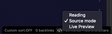

You could also use the keyboard to change mode using various commands, and there is also an option to enable Editor status from Settings > Editor > General, which will show the editor status in the lower right (see image below), allowing you to hit the icon and change directly to either of the available modes.
