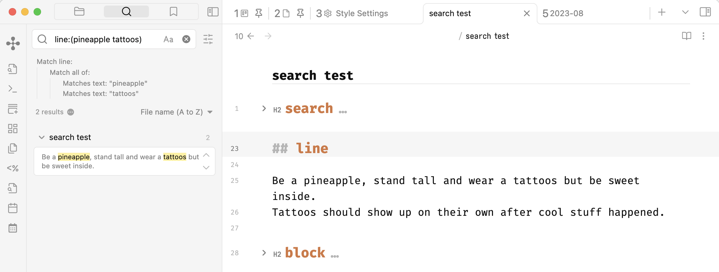

For me, line:() seems pretty straightforward.
Here, using line:(pineapple tattoos), I’m looking for lines that contain both pineapple and tattoos. No matches found.
If I add tattoos to the first line, I get a hit:

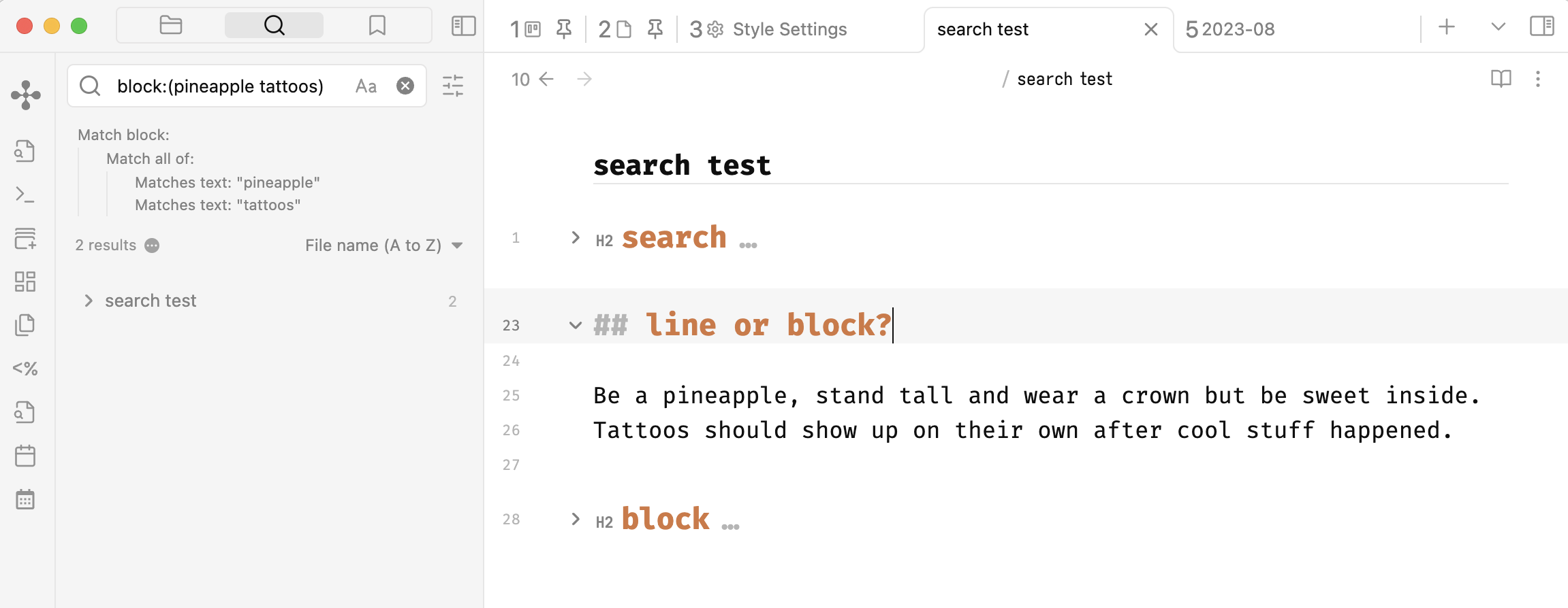

block:() can a bit unintuitive, I guess, at times. Is it a block or not? block:(pineapple tattoos) will return blocks that have both pineapple and tattoos.
Here, though the first line has a manual return after it, it’s still a block, so it matches.

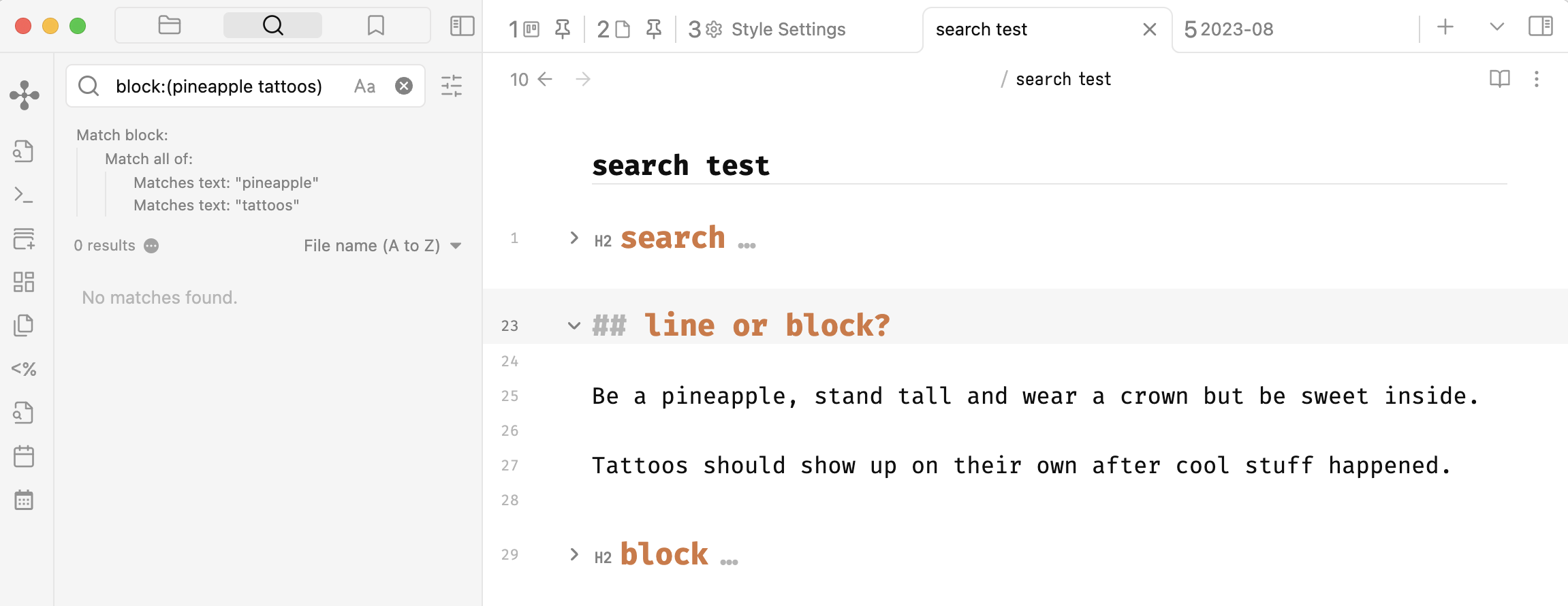

But, if I add a blank line, it’s no longer a block. No matches.
