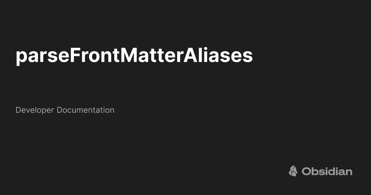

In the process, I was looking at a related plugin (task-archiver) and noticed that it called the obsidian API function parseFrontMatterAliases(). I have no idea what this function does. So I looked around and found only this:
As impressive as that link makes things look, the documentation for this function is pretty sparse. I see it takes a “frontmatter” argument. But there is no explanation of what this might be. I have only my intuition that it represent the frontmatter of a file somehow. Is it a string? Where would I get this string from?
