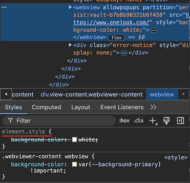

I’m using web viewer to use onelook thesaurus all the time. I’d like to change the background color to make it fit right into Obsidian.
I found this in the inspector:
I’d like the change white to var(–background-primary)
Anyone know how to target the iframe or whatever the element is to do this so that it’s persistent?

You could give this a try. The !important is necessary here.
.webviewer-content webview {
background-color: var(--background-primary) !important;
Depending on the theme, --background-primary may need changing, but that seems to do it.

Awesome. I didn’t even think about !important.
Thank you

Yeah, next time, if you see element.style in the DOM, you’ll need an !important to override it.
element.style is a part of your browser devtools that indicates the inline style of the element which has a higher specificity value than any CSS selectors.
That inline styles may be added by a JavaScript code, if so, you can override that declarations by using !important keyword within your stylesheet
https://stackoverflow.com/questions/28353386/what-is-element-style-and-why-is-it-overriding-my-css-settings
