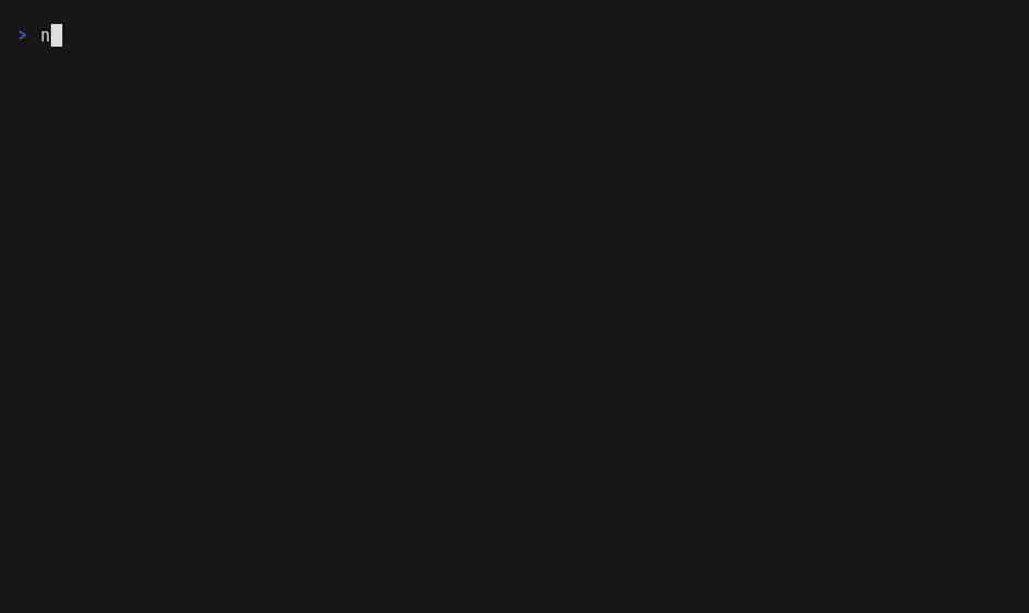

Setup
The local setup takes a few minutes with Docker and Node.js installed:
npx vault-cortex@latest init
The CLI asks for your vault path, generates the config, and starts the server. Keyword search works immediately and the semantic index builds in the background. The local guide walks through connecting Claude Desktop, Claude Code, and other apps, and it includes a plain Docker Compose path if you’d rather skip Node.
For access from other devices, the remote setup runs the server and Obsidian Sync together in one container (Sync is a paid Obsidian subscription, which the local setup doesn’t need). And if you’d rather not touch a terminal at all, that’s what the one-click deploys for Render and Railway are for: you click deploy, then sign in with your Obsidian account on a page served by your own server. The sign-in goes straight to Obsidian, and the syncing itself runs on obsidian-headless, Obsidian’s official Sync client. The whole thing lives under your own account, so you can delete it whenever you want, and your vault stays on your devices.

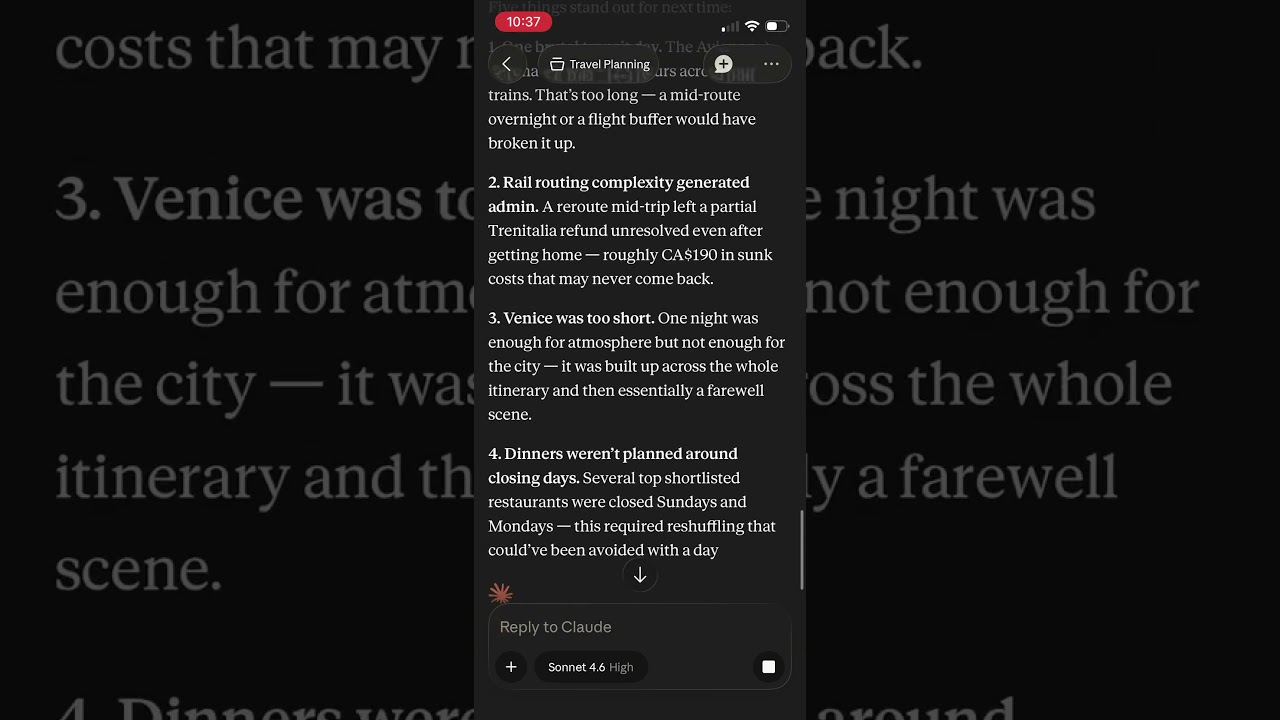

Here’s a short demo (58 seconds, no audio):
