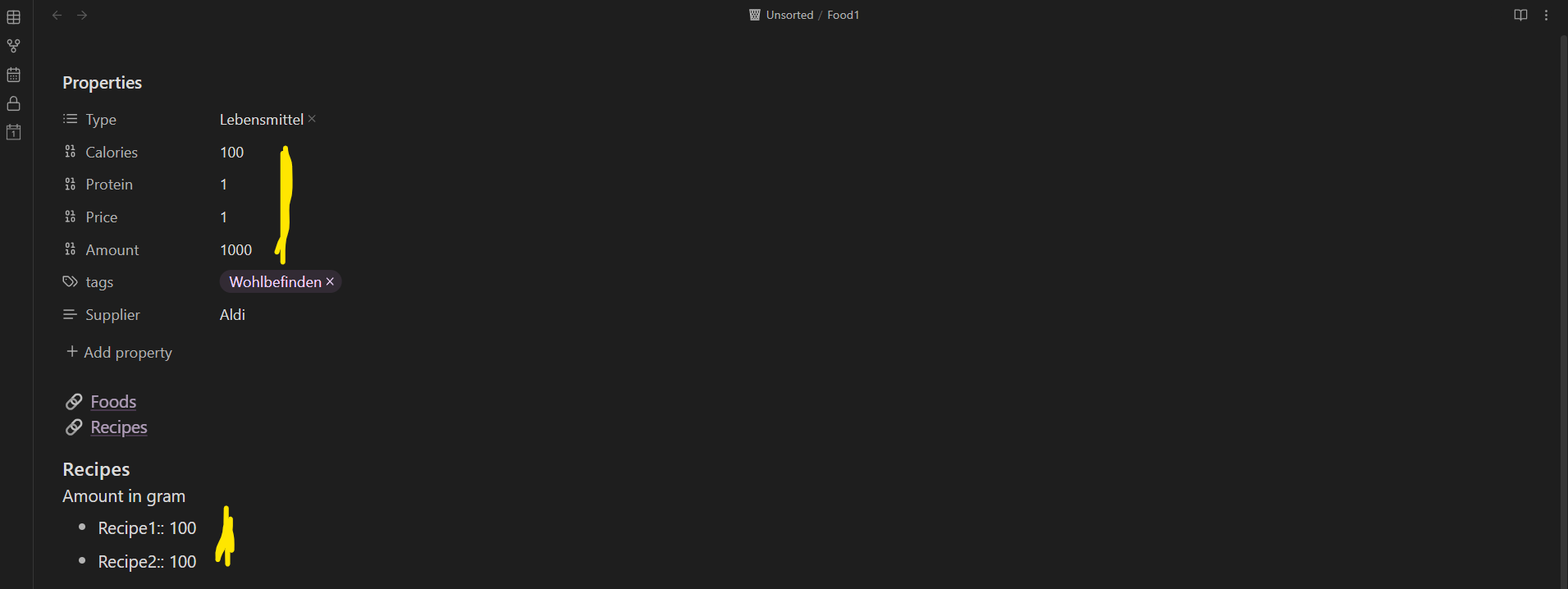

Let’s do a simple case study. Our recipe is “Egg and bacon”, which only uses “Egg” and “Bacon”. No seasoning or any other stuff. Lets keep it simple. If I understood you correctly this would result in these files:
- “Egg” - A food/Lebesmittel (from now on called ingredient) note also with references to “Egg and bacon” and some amount
- “Bacon” - A ingredient note also with references to “Egg and bacon” with an amount
- “Egg and bacon” - A recipe file, with no references to which ingredients it actually consists of… But it’s listed by text from the ingredients file…
Change recipe structure?
To me this structure seems backwards. I’d much rather have the ingredients listed in the recipe, instead of listing the recipes it is used in at each and every ingredient. With current structure when you add another recipe you need to edit every single ingredient of that recipe, and if you change the recipe you would also need to remember to remove/add it to those ingredients being changed.

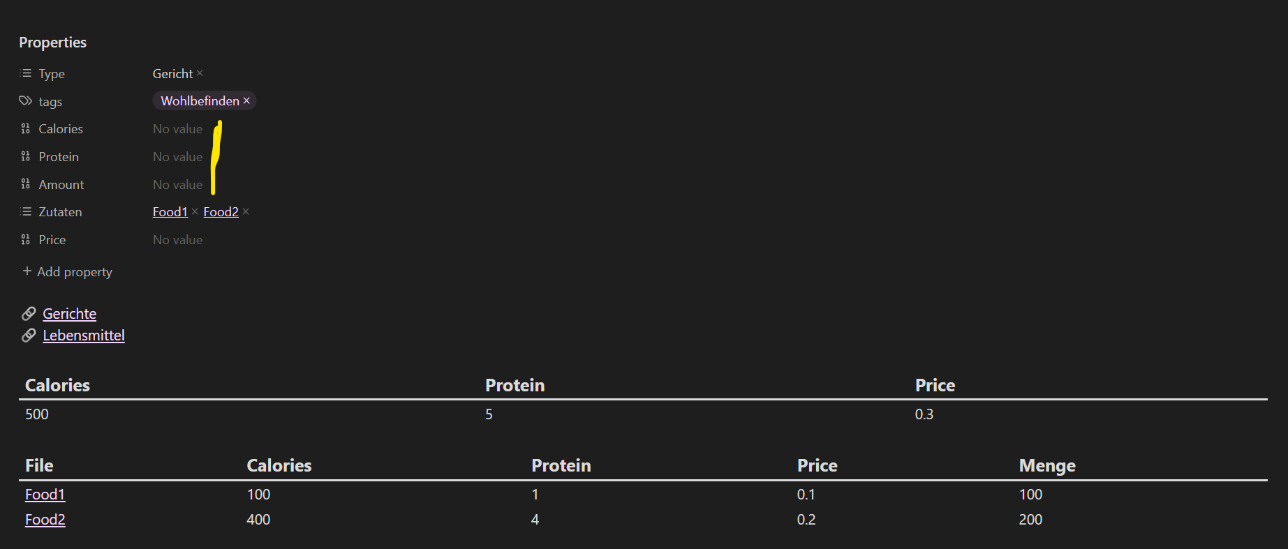

To me a better structure would look something like:
type: recipe
ingredients:
- name: "[[Egg]]"
amount: 2
- name: "[[Bacon]]"
amount: 5
And then use that in a query to calculate all the other stuff. Just for the sake of it with some random calories noted in the ingredients file, I could use this query:
