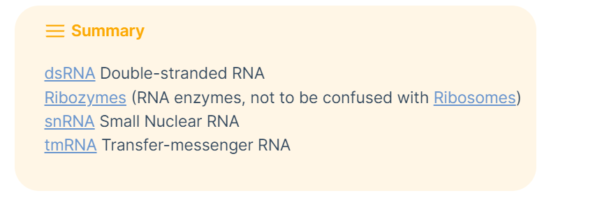

Using tab to align text in lists?
How can I align the descriptions so they are easier and faster to read? I don’t want to use a table inside a callout, as the table has a different appearance.
In Word I would use tab and it would align the start of the words nicely. How to do this in Obsidian?
I just have a few points to make:
  • I cannot see lists in your screenshot (lists in markdown are made with dashes);
  • you can define tabs to be 2 spaces or 4 in settings but they are to do with said lists;
  • in markdown any number of spaces are reduced to one space when rendered;
  • solution:
    • you can use lists like so (I put in two spaces then a dash here);
    • or you can use CSS snippets to format your text (some themes have elaborate Style Settings as well).
Probably a table is the easiest option (tho if you work in source mode you’ll still need to add spaces to align).
If you only need the alignment in edit mode, you could use spaces as suggested above.
Also as mentioned above, it looks like your text isn’t formatted as a list (tho maybe you’re using a theme or snippet that hides list markers).
Yes, it actually isn’t a list. I should have been more accurate in my description. I could make it to a list, but in this case I do not really want or need bullet points before them.
I suppose the issue is the same regardless if a list or not, as I need to align vertically the descriptions. But if changing to a list will make it easier I’d be willing to.
Another solution we used in Word was to make table without borders.
Thank you. But that just sounds too complicated and time consuming. I’ll probably just do without and focus on content. But it’s a pity that such frequently used text editing feature is not possible in obsidian without going to extreme lengths.
I could use a table, but in that case it would be preferable to have table without any borders or headings? Is that possible? Basically to be there just to control spacing.
You can use a CSS snippet to remove the borders.
The header row is required but I think you can leave it empty and probably hide it with a snippet. Someone has probably posted working options for both either here or on Discord.
Will the CSS snippet remove the border only for tables that are used for that purpose? Or will it affect all tables, including tables I need to have borders? Thanks.
I’m not an expert, but the only way I know that you might be able to target any table anywhere is by putting the table in a callout and targeting that combination. (You’ll of course want a custom callout that is styled to be invisible like the table.) I don’t know if tables work in callouts. If not, the nearest thing I know of is the cssclass property, which would let you target all tables in specific notes.
