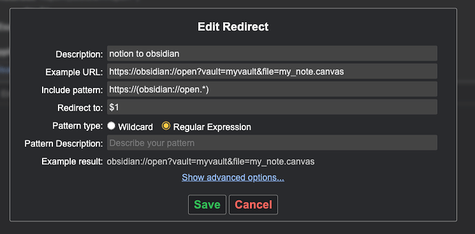

How I find the best is to install a Chrome extension that finds the pattern and redirects to the Obsidian URI.
https://obsidian://open?vault=… → obsidian://open?vault
You need to add the ‘https://’’ in notion to be able to recognise it as a link, a bit annoying but it works.
The extension is https://chromewebstore.google.com/detail/redirector/ocgpenflpmgnfapjedencafcfakcekcd and you need to configure it like this:
