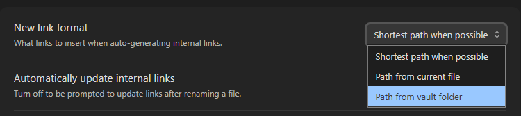

When you do click “Accept Once” it just updates the path in the property to a full path. Cant that be done from the beginning? instead of having to update it only when theres same named files?
yes, it can be done in the beginning. That’s what “Path from vault folder” is for. If you are okay with it, use it. We should still handle the problem you raised on note creation when using the default “shortest path”. It seems to be pretty specific to note creation (hence collision of “Untitled”), note rename is already handled.
Ok i really appreciate you sharing that, i honestly didnt know that was an option.
