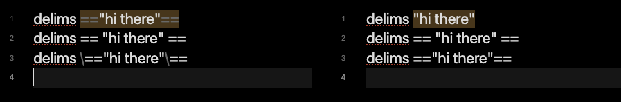

Two equal signs is common to use for highlighting, and this is what you’re experiencing here. To avoid it, you could either add spaces around the ==, or you could add a backslash in front of it, like doing \==.
In the image, source mode to the left, and live preview to the right (which is the same as reading mode except for line numbers in front). As can be seen, the second and third line do not highlight the phrase “hi there”.
Since this is code it would be best to put it into a code block
