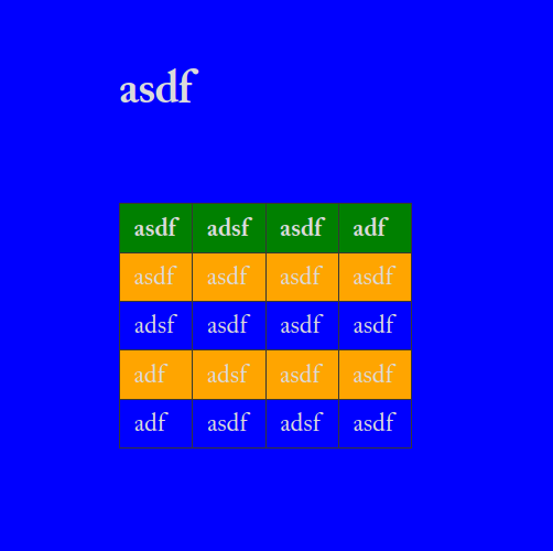

I would like to have a table, with alternating colors row-wise, and with a third color for the header. None of the colors should be transparent, i.e., the background of the “paper” should never be seen in the table.
I thought this could be solved by setting --table-background (it sets the default background of all cells, unless something else overwrites it - right?) to some color - this would color the odd rows in the end.
--table-header-background would set the color of the header and it would overwrite the previous value set by the --table-background variable.
--table-row-alt-background would set the color of the other rows (even rows) - again overwriting the default value set by the --table-background variable. Here is an example of what I want (note: not actually the colors I want to use, but this makes the example easier):

The image below is a simple representation I made in GIMP, for what I am trying to do
The css file I am using looks like this:

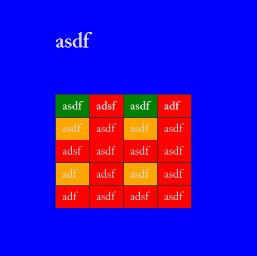

The issue
What I actually get looks something like this:
What is interesting is what happens when I comment out the --table-background, then I get the (to me) intended behavior, except every second row is now transparent:

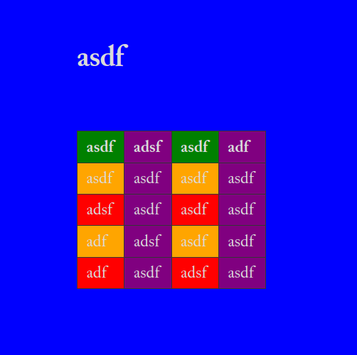

As far as I can see the reference page for the css variables for the table class, it does not mention anything about coloring alternating columns by default when using the --table-background variable. As can be seen in my css file, I have also tried to comment in the --table-column-alt-background variable (I chose purple to show which cells it affects) - but that overrides everything in the alternate columns, even the header:

Add this:
--table-column-alt-background: unset;
It appears that Obsidian sets the alternating columns background to equal the table-background variable. Unsetting it fixed the columns in the default theme when I tried it just now.
All Hail dawni!
It worked - thanks you so much :slight_smile:
