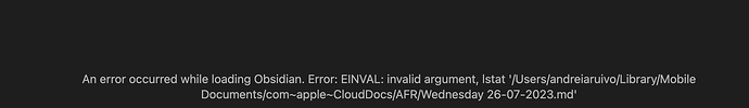

Hello, I’m French. I have a vault on a hard disk that won’t open. It shows me an error: “An error has occurred while loading Obsidian. Error file system operation timed out.”
What’s the problem?
Can you help me reopen it? Thank you for your help.

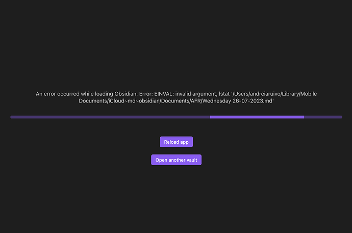

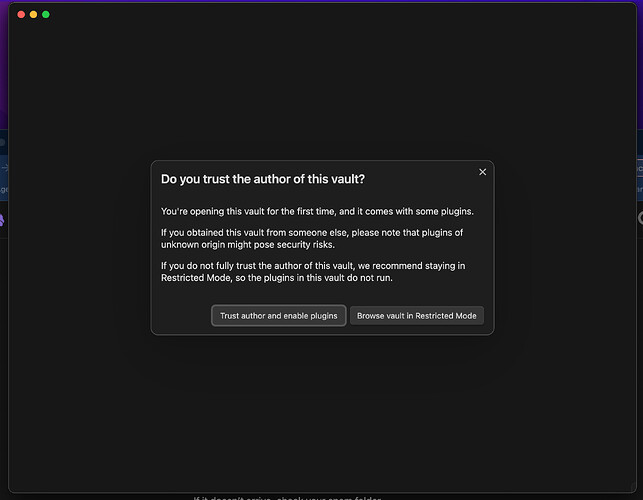

I am getting the same error, I’ve updated to 1.4.5 and this has been going on for weeks. After persisting I see a pop up message, which asks:Do you trust the author of this vault?
Any ideas what is going on and how I can solve this?
It’s not the same error or file system. Your issue is iCloud related. There are tons of iCloud related issues talked about on the forum.
Otherwise, accept to trust the author and enable plugins.
Hi @gino_m thanks so much for your reply, I will search for icloud issues in the forum then. I can’t manage to click to accept to trust the author and enable plugins.

Status: I can open my vault on the mobile app but not on the iOS app, when I try to open the vault on the desktop app I get the error (as shared above).
Operating System - macOS Montery 12.6.8 (needs updating to Sonoma 14.1.2)
Obsidian Version - 1.4.16
Vault Location - icloud. I moved it a few times, but the issue started when Obsidian launched an update a month (?) or so ago.
Any idea what I can do?

Finally, I wonder what the contents of the Wednesday 26-07-2023.md file are?
I don’t need to know, just try to copy the contents of it in a plain text editor, keep it safe, try deleting the offending file and opening the vault again.

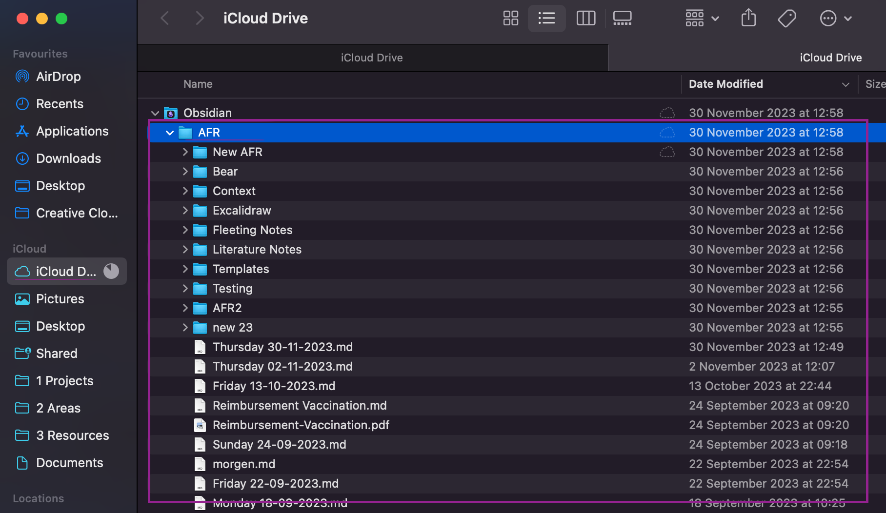

There is no file Wednesday 26-07-2023.md inside the icloud based Vault…
