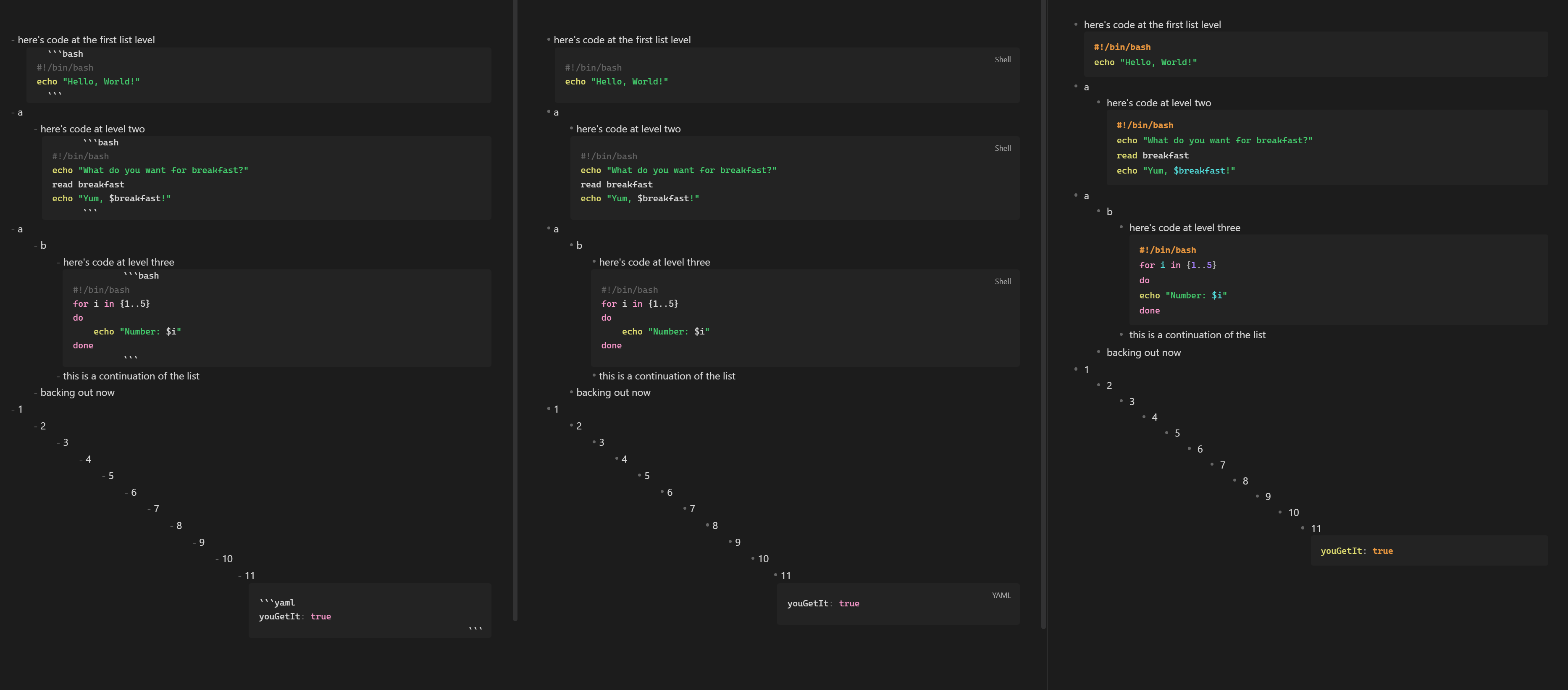

Trying to make codeblocks appear correctly in lists
Obsidian is not showing codeblocks correctly indented in lists and I’m trying to fix it with CSS. I have a partial solution, but I can’t make it fully work, and I was wondering if someone else might see a solution.
This is my current snippet:
 * FIX: Codeblocks in lists
/* NOTE: THIS FIXES ONLY UP TO 3RD NESTED LEVEL!!! */
 * General codeblock fix: start of codeblock
 * NOTE: the values might need changing with different font...
/* Reset default base rule */
.cm-line.HyperMD-codeblock.HyperMD-list-line {
	margin-left: calc(var(--list-indent) * 1 + 0.2em) !important;
	width: calc(100% - var(--list-indent) * 1 + 0.2em) !important;
/* Level 2 List Codeblocks - Add extra alignment tweak */
.cm-line.HyperMD-list-line-2 ~ .cm-line.HyperMD-codeblock.HyperMD-list-line {
	margin-left: calc(var(--list-indent) * 2 + 0.4em) !important;
	width: calc(100% - (var(--list-indent) * 2 + 0.4em)) !important;
/* Level 3 List Codeblocks */
.cm-line.HyperMD-list-line-3 ~ .cm-line.HyperMD-codeblock.HyperMD-list-line {
	margin-left: calc(var(--list-indent) * 3 + 0.8em) !important;
	width: calc(100% - (var(--list-indent) * 3 + 0.8em)) !important;
 * General codeblock fix: indent fix
/* Hide the structural bullet indent span */
.cm-line.HyperMD-codeblock .cm-hmd-list-indent {
	display: none !important;
/* Level 2: Pull text back by 1 tab step (28px) without altering span widths */
.cm-line.HyperMD-list-line-2 ~ .cm-line.HyperMD-codeblock {
	text-indent: -28px !important;
/* Level 3: Pull text back by 2 tab steps (56px) */
.cm-line.HyperMD-list-line-3 ~ .cm-line.HyperMD-codeblock {
	text-indent: -56px !important;
/* Ensure ALL spans render full pre-formatted whitespace for code indents */
.cm-line.HyperMD-codeblock span.cm-hmd-codeblock {
	display: inline !important;
	width: auto !important;
	max-width: none !important;
	min-width: 0 !important;
	white-space: pre !important;
This makes the codeblocks align nicely up to 3rd nested level (and obviously similarly further if desired), however, if I make a new list in the same note or continue the list, the text stays correctly indented (there might be a small difference, but looks decent), but the background is staying at level 3 nested level.
The issue with targeting different levels is that the codeblocks in lists are always .HyperMD-list-line-1, no matter what the actual nested level is. Does anyone have any ideas how to fix this?

I cheated. The math proved to be wrong by level 11, so I made up an offset. Math aside, that’s how to target the levels.

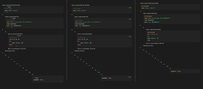

It does the same as mine: the issue being if you have a codeblock at nested level 3 and then one at level 1, the block stays at level 3… It works as long as you don’t go back…
I’ll check out the “going back” issue.
As for going only three levels, if you keep saying that as a proxy for any level, then ignore the rest of this. Just in case you mean literally the third level: Do you see the three dots “…” in the code. That’s for you to fill in the rest of the levels. I typed out the first three for you. And then the ellipses. Then added a level 11 so you could see how the pattern.
I managed to get it working. It’s painful, but I think I won’t need very large codeblocks nested in lists… but this actually works, now to level 4, but only up to 10 rows of code per block, because I got tired of copy pasting…
