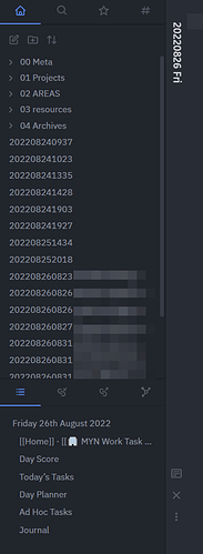

This is not exactly answering your questions, but for what it’s worth, I use the root folder as my inbox.
I do my filing in 4 folders in the root of my vault, and incoming files are sitting outside of those four folders.
I’ve done it this way as I have .md files being programmatically generated from multiple sources (including readwise) and placed in the root for simplicity. It had an unintended side-effect which was to force myself to process my ‘inbox’, as my vault looks really untidy if there are loose files in the root of my vault.
I have CTRL+M as a ‘move to file to another folder’ hotkey to speedily file it away once processed.
Works for me!
