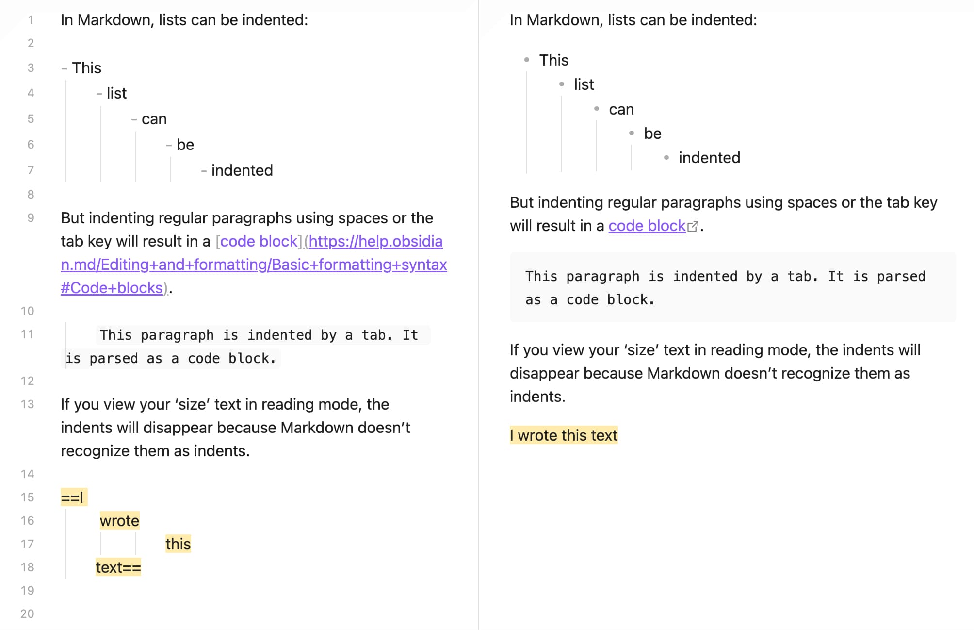

Hello.
In Markdown, lists can be indented:
  • This
    • list
      • can
        • be
          • indented
But indenting regular paragraphs using spaces or the tab key will result in a code block.
This paragraph is indented by a tab. It is parsed as a code block.
If you view your ‘size’ text in reading mode, the indents will disappear because Markdown doesn’t recognize them as indents.
Using markdown, pressing tab multiple times will result in blocks turning into cider blocks when b you go above 4 spaces.
To properly indent you either need to use callouts or blockquotes to get multiple levels, or lists at various levels.
