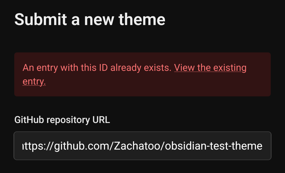

I’m not able to submit a new theme that has the same name as an existing theme, this is the error I get.
I also checked obsidian-releases/community-css-themes.json at master · obsidianmd/obsidian-releases · GitHub and did not find any duplicate themes with the same name. There are some near collisions but no exact duplicates.
I don’t think there’s an issue here, it is impossible to submit a duplicate theme and there are no existing duplicate themes.
