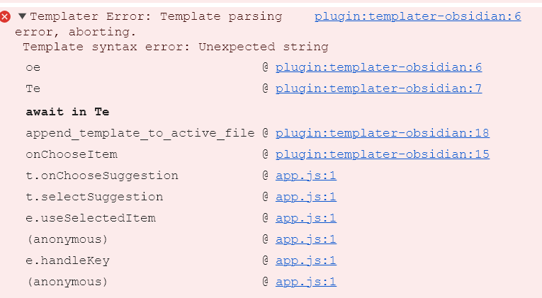

I’ve been waiting for something like this. I tried it out but get this error:
Strange.
Did you make sure to copy and paste the entire script correctly (for example, using the copy button in the top right corner)? And did you run the script by using the ‘Replace Templater’ command while being on the note where you pasted the script?
Thanks. If I run “replace templater” in the note with the script, it erases the script. If I activate the template as usual, it doesn’t convert the inline properties in the specified folder.
