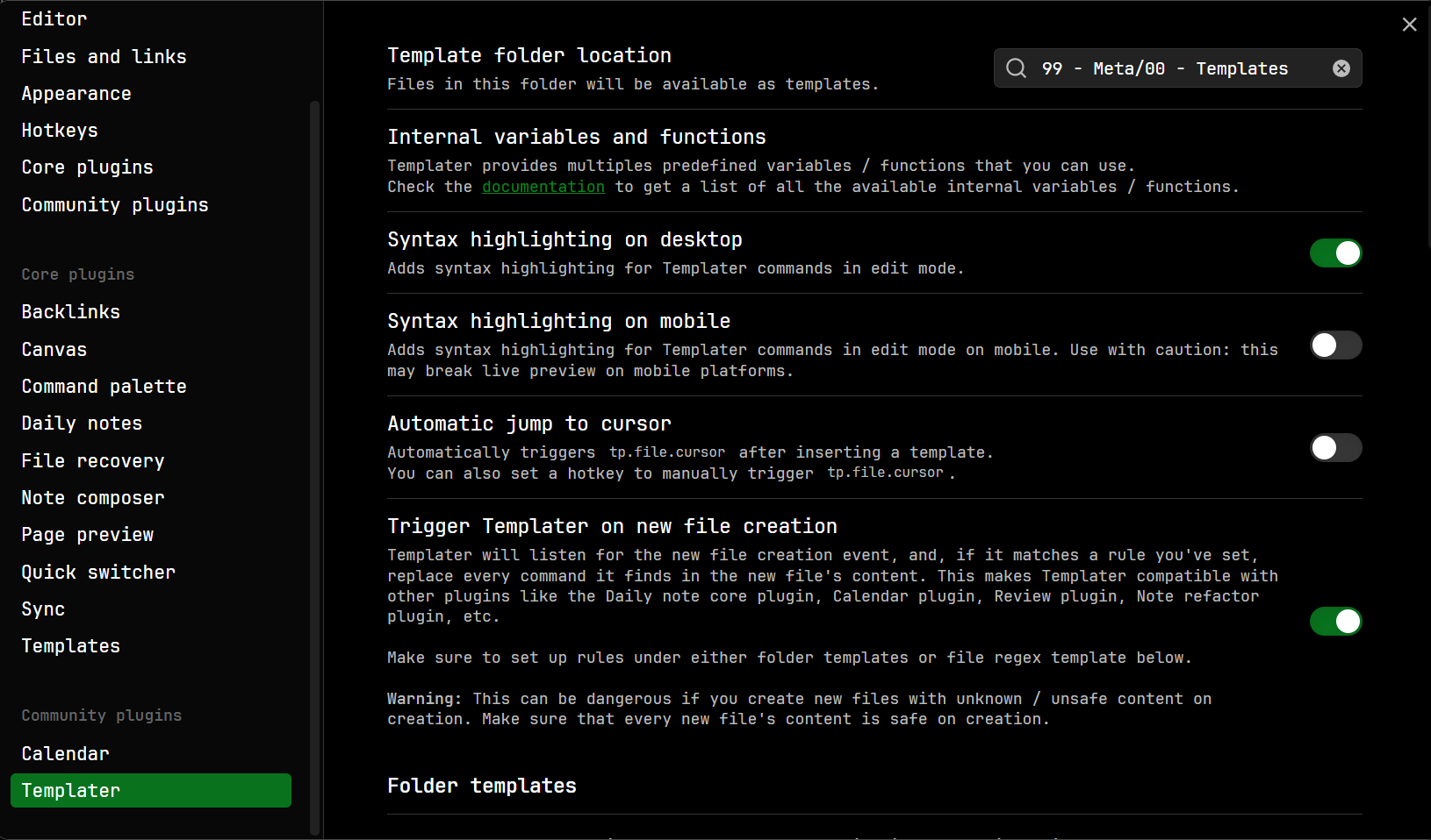

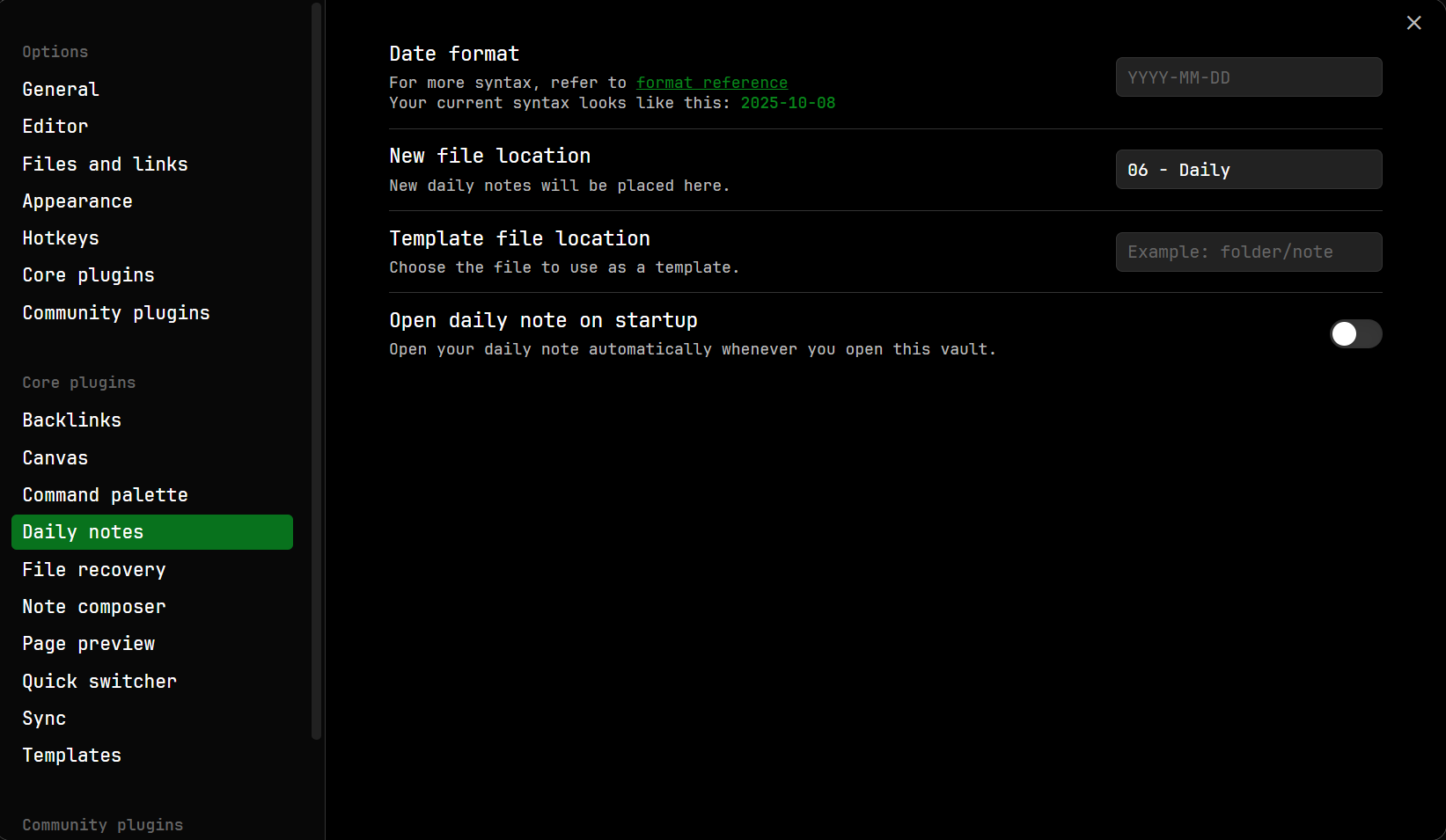

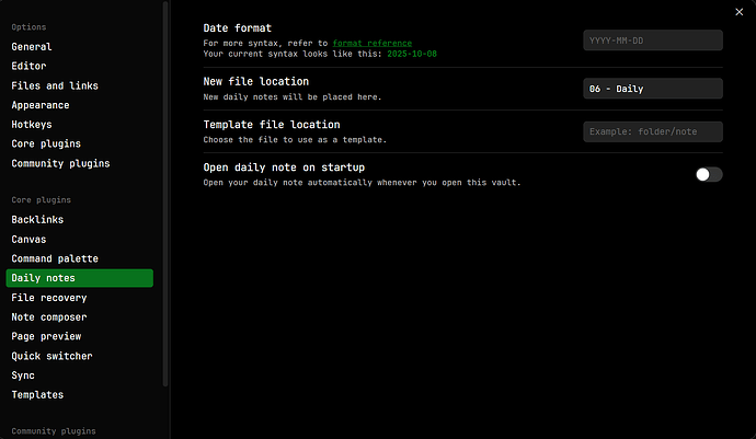

  • Post a screenshot of your core Daily notes settings.

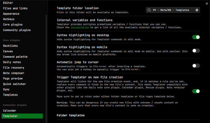

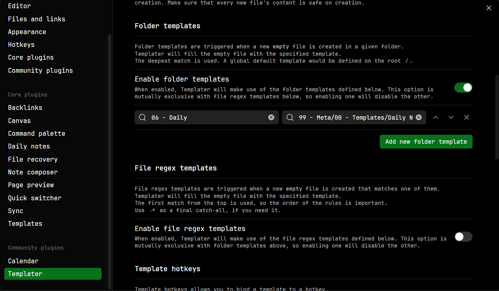

  • Post a screenshot of your Templater settings (including the “trigger Templater on new file creation” and “folder templates” sections).

Following up, here is my template for the daily note as well as my settings I have for templater and daily notes

Your settings look good and I can confirm the daily template, as is, doesn’t output anything. Looking at the template, there are a few issues I see:
