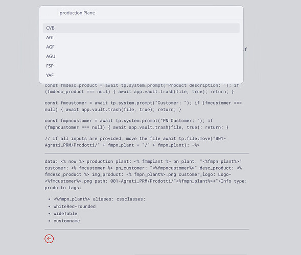

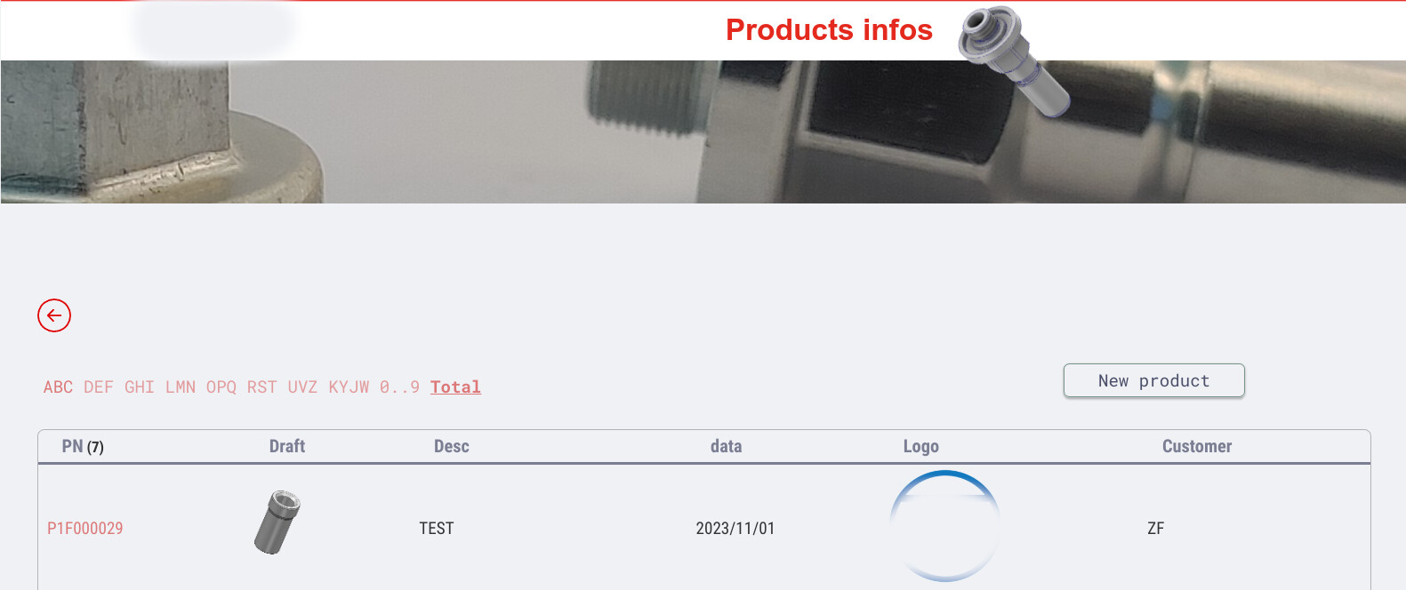

When I press the button and activate Templater, the system initiates the form compilation process before creating the note. Unfortunately, this process displays the source code of the note as a background, which is aesthetically unpleasing. I would like to see a blank page or remain on the initial screen when I press the button.
Before pressing the button :
After I have press the button :
