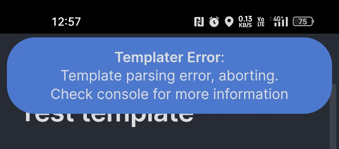

This doesn’t seem to work on mobile, the prompt does show up, but it says that there is a parsing error

i used the Create new note from template command, I just copied and pasted what you put in the code block into a new note called “Test template”. it also didn’t like the front matter, I think it has to be the first line of the document to render properly. it rendered the first --- as it would in source mode, and it rendered the second as a horizontal rule.
edit: I checked on desktop, and it still gives the same error, it turns out that the lack of any template was just because, on my phone, I have it set to make new notes in the same folder as the current file, so it never activated any template. on desktop though, it’s set to make them in a specific folder, which activated the template for that folder.
I tried this, but it unfortunately doesn’t work for me
I assume that when you’re saying “on desktop though, it’s set to make them in a specific folder, which activated the template for that folder.” you are referring to folder templates? I was recently informed by @Zachatoo (the current Templater maintainer) that folder templates aren’t meant to be applied concurrently with Templater commands like “Create new note from template”. Only the template chosen by the command ought to be applied.
What I shared was put together a bit too fast from another template of mine. After testing, it appears that the Templater error was due to newTitle not being a global variable, so it was only available within the scope of the conditional. This should fix that:
