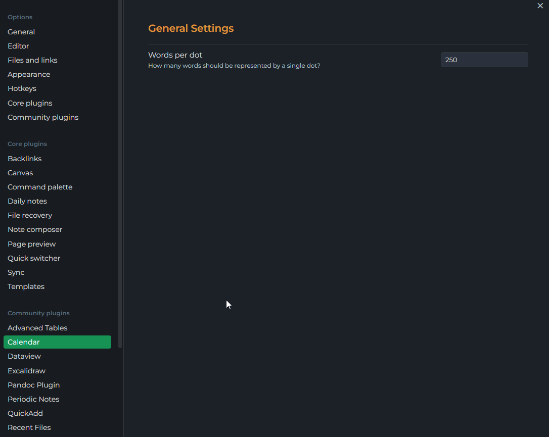

The settings are missing. I’ve attached a screenshot below. They only appear if I toggle the plugin on and off, but after applying any template, the settings disappear again. I’m not sure what could be causing this.
Here is I’m talking about:

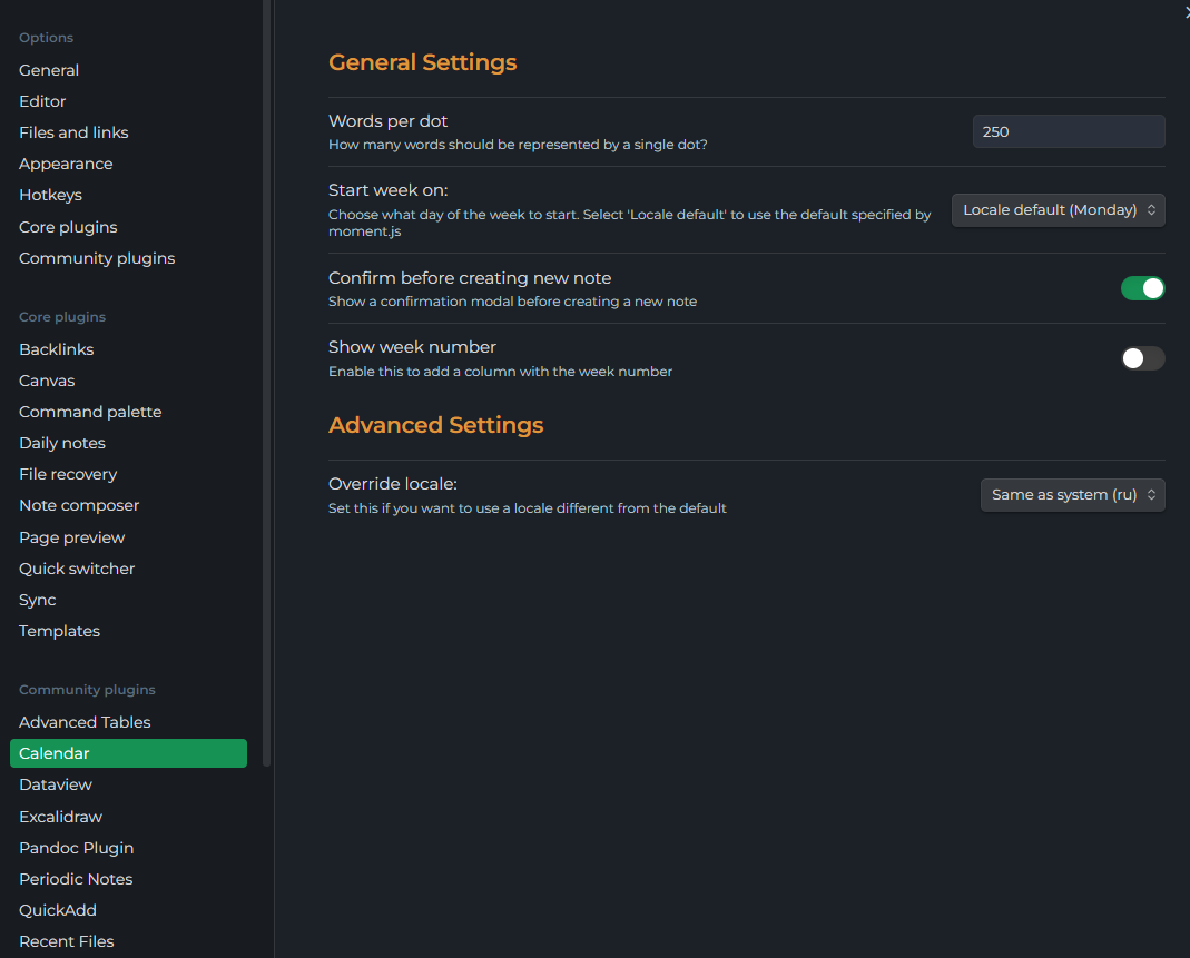

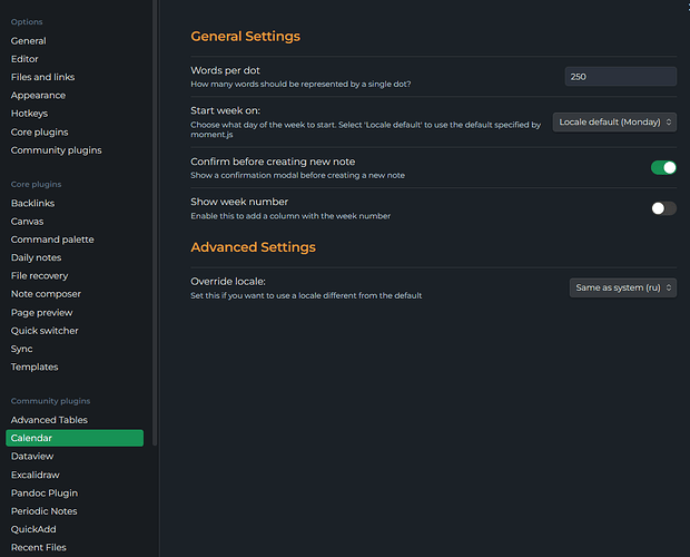

After restart:
As you can see Calendar plugin have “Monday” as start of week.
