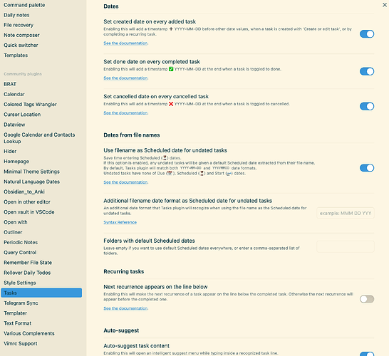

My Daily Notes format is standard/default. See screenshot.
Creating a task in this file should (according to the docs) set the Scheduled date to, say, 2024-03-13, because the name of the file is 2024-03-13.md.
This does not happen for me.
The Tasks plugin settings are shown below.

@holroy I’ve created a new file, named it 2025-03-13.md. There are no other files which have this name in my vault and include any suffixes or prefixes. This was to test if removing the suffixes fixes the problem. It does not.
It appears that others do not have this problem, and if myTasks plugin settings are correct, this must an issue with my set up. Help with identifying this issue is appreciated.
