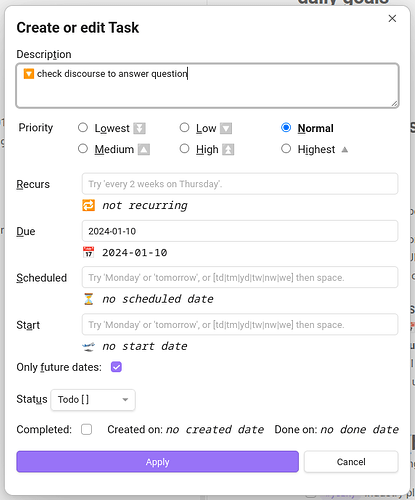

I like to put my task priorities at the beginning (see attached picture) when I’m creating a new task. This way I can quickly evaluate whether something is wort doing without having to search for the tag emoji in the varying lengths of my task descriptions.
Now here’s the issue. The tasks plugin will only recognize the task priority of the emoji is placed AFTER the task description. Notice how all my tasks have been grouped as “normal priority”, and how the priority emoji is recognized as part of the description.

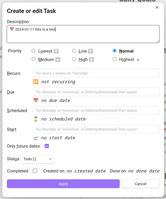

Here’s another screenshot to show that the date attribute also doesn’t work when put at the beginning:

Hi, maintainer of Tasks here…
so he can see them more easily
… or she …
A report was created:
I’ve added a comment to it, with links to the relevant bits of the documentation, and to the existing request we are tracking this known limitation in.
It would indeed be lovely to remove this limitation from Tasks, and I’m sure it will happen at some point.
