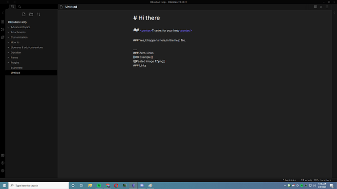

Hello and thanks for your reply.
I’ve tested out this problem in the Help File and got the same issue.
Here some attachments:
Edit mode
View mode

Btw,I actually found out what caused the problem.
Even if I use obsolete tag,I can fix the problem.
The thing is… I wrote wrong second element(which is stops action of the tag.)
So proper way to code it is <center> some text </center>
But I didn’t close the tag so I wrote <center> some text <center/>
So I placed slash in the end and this is why this happened.
