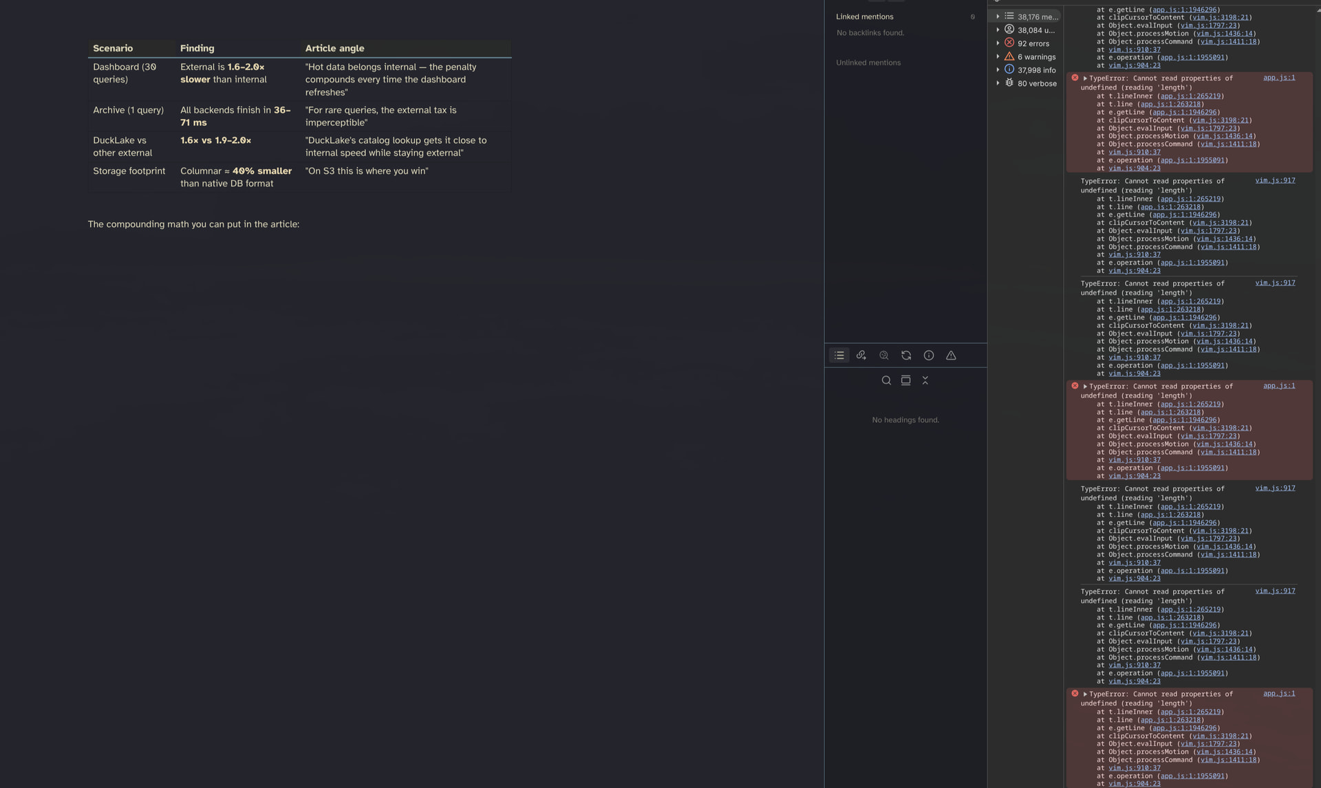

Tables in Vim mode Error: TypeError: Cannot read properties of undefined (reading 'length')
  1. Activate vim navigation
  2. Open Dev Tools and see console
  3. go inside a table and navigate with vim

vim.js:1006 TypeError: Cannot read properties of undefined (reading 'length')
    at t.lineInner (app.js:1:250274)
    at e.line (app.js:1:248273)
    at e.getLine (app.js:1:1137920)
    at clipCursorToContent (vim.js:3093:21)
    at Object.evalInput (vim.js:1709:23)
    at Object.processMotion (vim.js:1371:14)
    at Object.processCommand (vim.js:1346:18)
    at vim.js:999:37
    at e.operation (app.js:1:1146299)
    at vim.js:993:23
    at Object.handleKey (vim.js:864:18)
    at doKeyToKey (vim.js:1053:31)
    at vim.js:997:19
    at vim.js:993:23
    at Object.multiSelectHandleKey (vim.js:6237:28)
    at e.handleKey (app.js:1:1156852)
    at e.keydown (app.js:1:1157905)
    at app.js:1:375614
    at e.runHandlers (app.js:1:373670)
    at e.handleEvent (app.js:1:373432)

Just an update - in the meantime, I switched to Linux (Arch) and use Obsidian there happily too. But the error still exists - if I navigate with vim motions inside of a Markdown table in the live-preview mode:
Error:
TypeError: Cannot read properties of undefined (reading ‘length’)
at t.lineInner (app.js:1:265219)
at t.line (app.js:1:263218)
at e.getLine (app.js:1:1946296)
at clipCursorToContent (vim.js:3198:21)
at Object.evalInput (vim.js:1797:23)
at Object.processMotion (vim.js:1436:14)
at Object.processCommand (vim.js:1411:18)
at vim.js:910:37
at e.operation (app.js:1:1955091)
at vim.js:904:23
