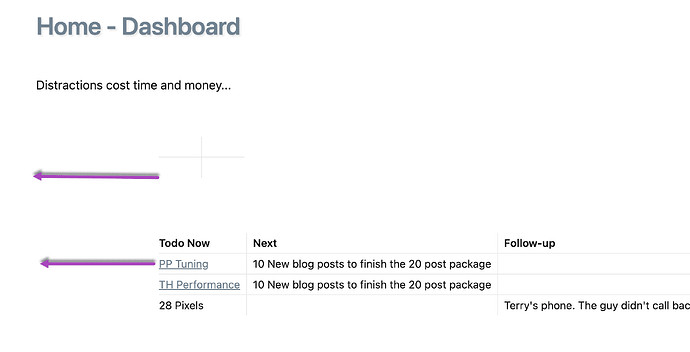

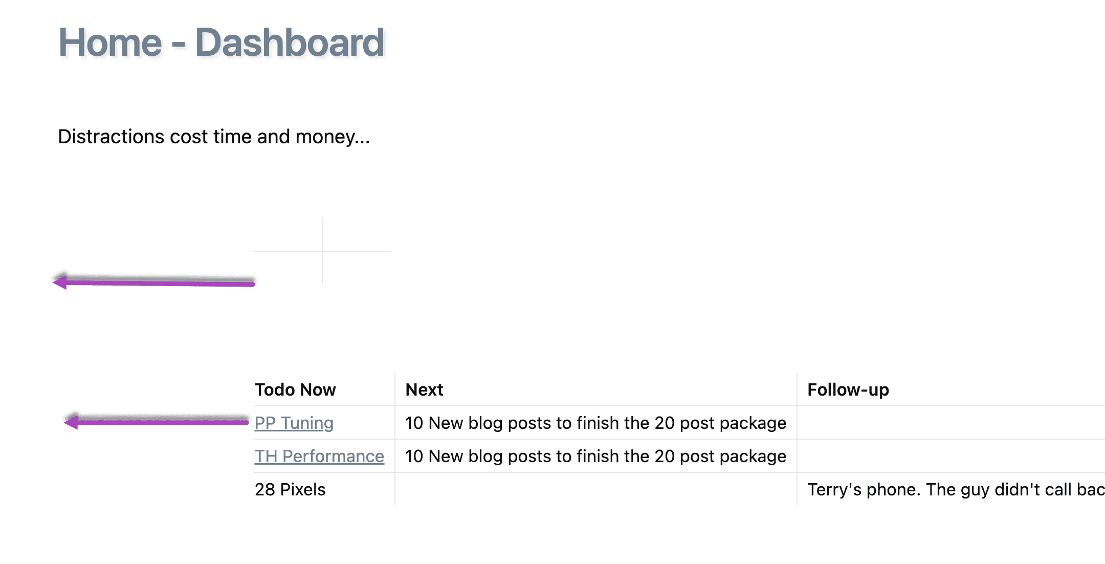

I’ve been trying to easily create a table for layout but while using the minimal theme, every table I create has a big margin (or padding) on the left (shown in the screenshots).
I tried other table plugins but even with Advanced Tables (etc), I’m still getting the big space.
I have looked at CSS and tried editing it but can’t get it fixed.
When I use a different theme, the space is gone.

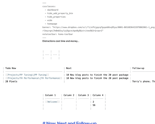

Not at my desk at the moment to check, but you have wide in the cssclasses. Try adding table-wide as well.
https://minimal.guide/features/helper-classes#Block+widths
table-wide makes it look correct while editing, but in read mode (preview), the problem remains.

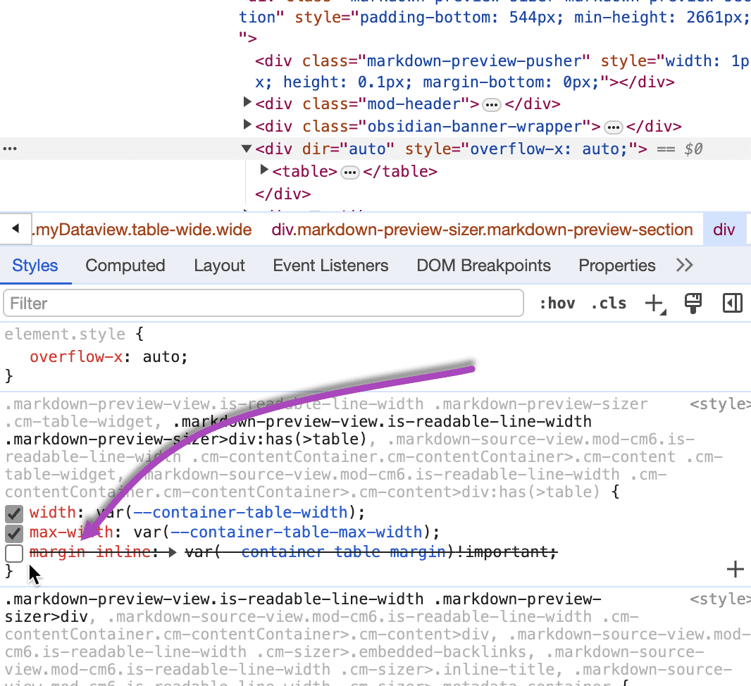

While in Preview, if I disable one line of CSS, the table goes to the left where it should be:
margin-inline: var(--container-table-margin)!important;
Does that help to identify the issue?

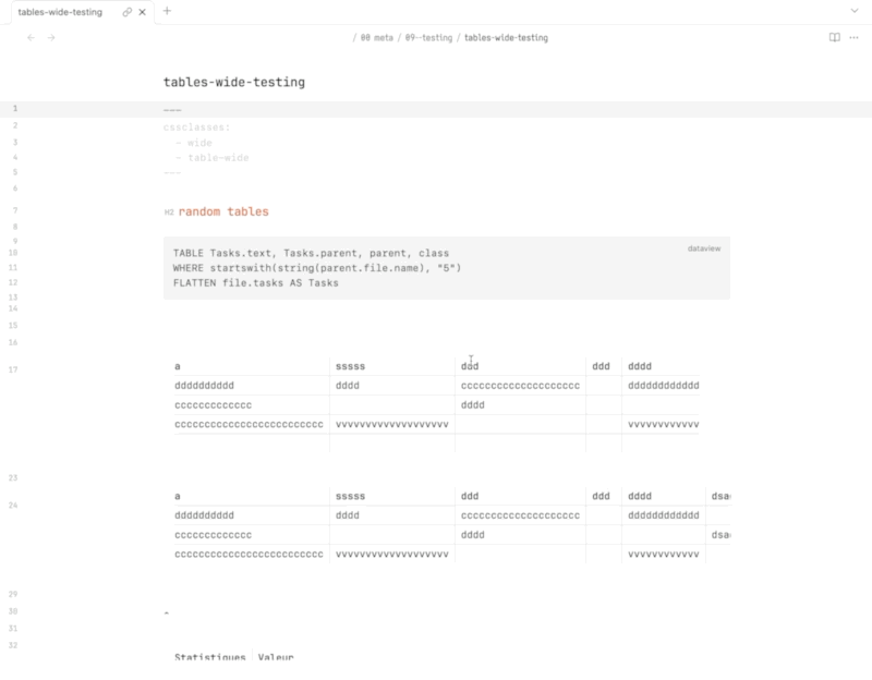

The editor and Reading view look fine on my end using wide and table-wide.
CleanShot 2024-06-09 at 08.46.50
I’d try updating Minimal – there have been a few updates the past few days – and also check it’s not the dashboard or homepage CSS jamming things up.
