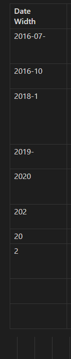

In one example, it looks like the first column had a repeated “Truncate right-most character” operation, row by row. Notice how each successive row is missing 1 character until the cell is empty. Two rows after that, the table goes completely bananas and there are vertical column lines without any rows.

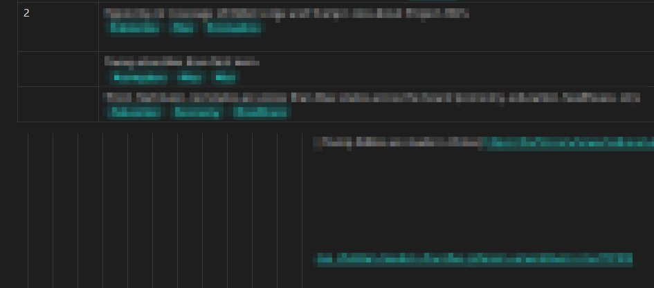

And then somewhere along the way, other cell data shows up, but the leading information from who-knows-how-many cells is long lost. And this isn’t a display/rendering issue. If I view in Source Mode, I can see loads and loads of white space start to creep in, and the data in question (such as truncated dates seen above) renders the exact same (in that, it’s missing/gone).

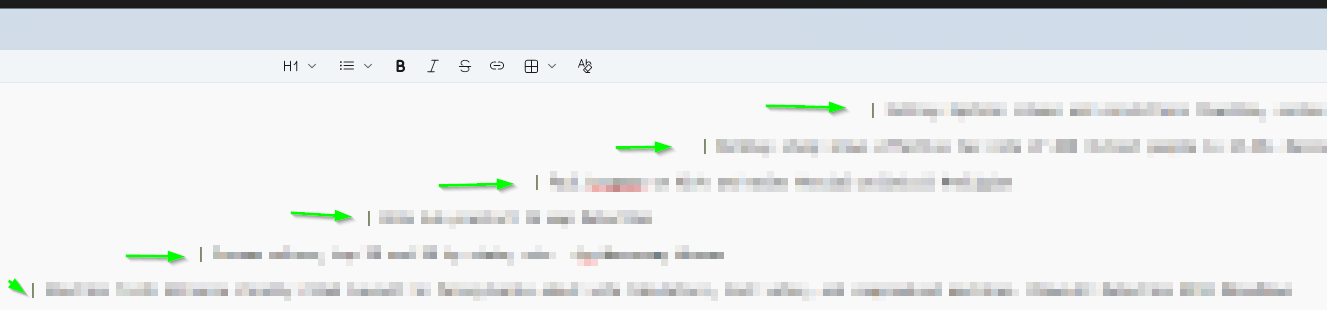

If I keep on scrolling, new patterns emerge: a reverse-stairstep of indentations (here, pasted in Notepad, as I was trying to troubleshoot and see if it was something as “simple” as a missing pipe where the rows started getting janky):
I do not use any of the aforementioned table commands (like “ALT+UP” to move rows). I simply tab to a new row, free-type or paste data, and go about my day, until one day, things are corrupt.
