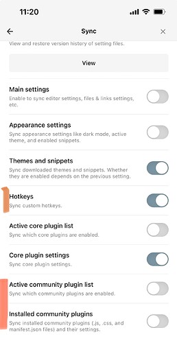

These settings will need to be toggled on for all devices:
And when you change any settings, you’ll need to restart for Sync to pull in the changes.
