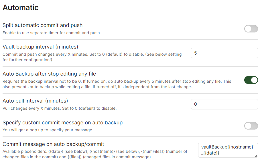

While the syncing issue above was reproduced while the Obsidian Git plugin (2.22.0) was disabled (since 11-10-2023), I suspect the plugin has interfered with syncing and checked it this morning.
Could this be part of the issue?
No, sorry. I’ll share it hoping it is helpful still.
  • All plugins and themes were up-to-date.
  • No CSS snippets enabled.
  • Using the default theme.
  • Obsidian Git (2.22.0) was enabled with adapted settings (shown below) to see if this would resolve the sync issue.
  • Obsidian Git only runs on my laptop
  • “Auto pull” has been disabled since installing the plugin.
  • I checked the repository’s history to confirm git was indeed not interfering with sync when I reproduced the issue. Last event before reproducing the issue: image
