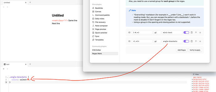

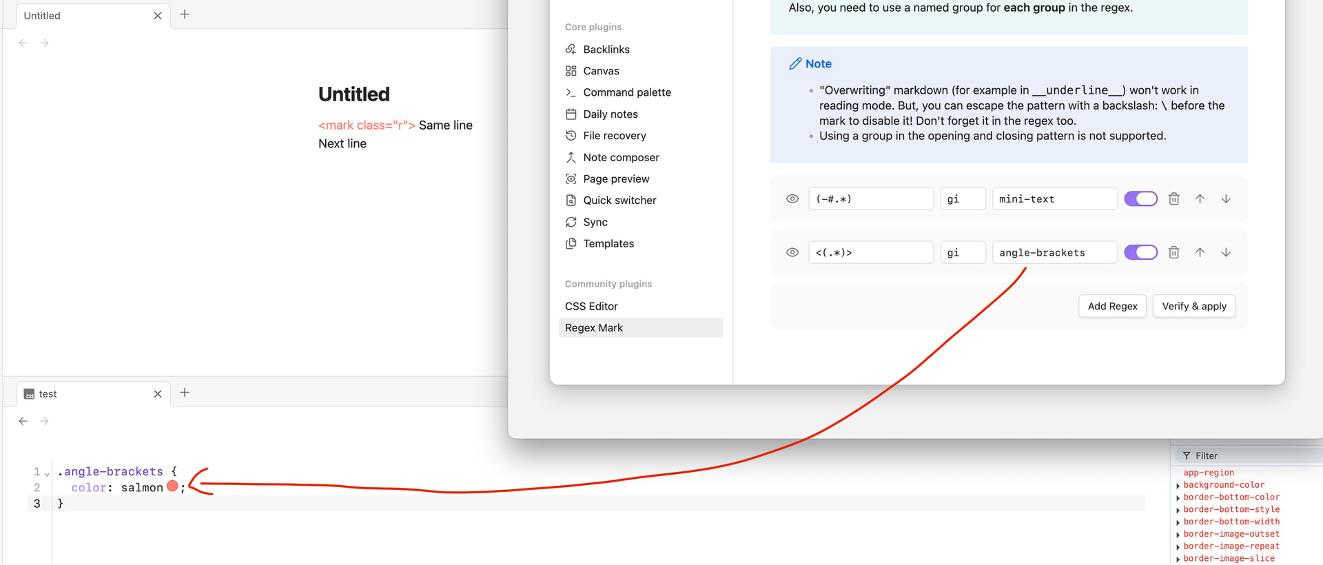

You could try
for this. A quick example:
<(.*)> captures anything between the angle brackets and can be targeted with CSS.
Can confirm: simply adding = as the regex group, and then in a CSS snippet using that group’s name you gave it, and e.g. opacity: 0.3; will create the desired fading of the character.
