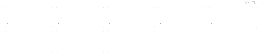

Adding a flatten:
TABLE WITHOUT ID L.name AS name, L.rating AS rating, L.summary AS summary
FROM ""
FLATTEN file.lists AS L
where file.name = this.file.name
Complete disaster

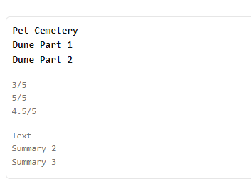

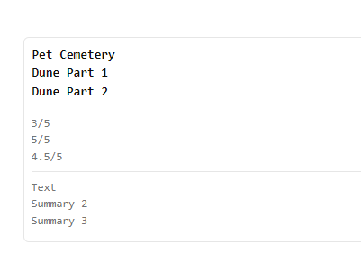

Re-reading this I realise that the issue is with my lack of understanding of minimal cards. Without the cssclasses cards the table shows correctly
Though its a shame the sub bullet points aren’t collected into the summary.
When I add the cards css style the cards display as a single card:

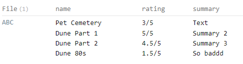

TABLE name AS name, rating AS rating, summary AS summary FROM "" where file.name = this.file.name
Removing the WITHOUT ID the table renders thus:
My suspicion is the cards style is treating the items as a single card because there is only one File(1)

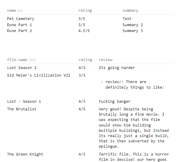

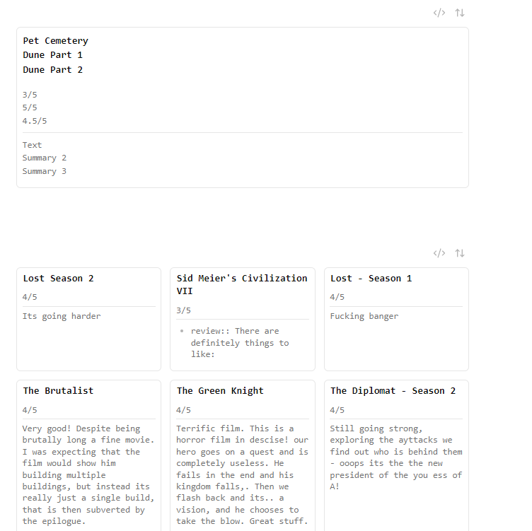

So here are two dataviews:
and with cards css
It feels like the only difference is the number in brackets on the first column.
