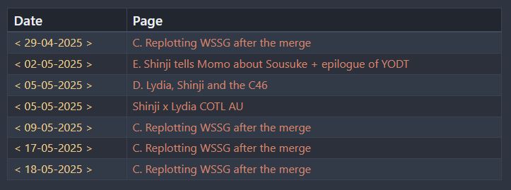

Now, June currently displays like this:
Even though May displayed like this:
(Don’t mind the dates from other months, it’s due to the fact that some pages have dates from several different months in the Entries property. I don’t like it, but it’s a different problem from the one I’m trying to solve here)
I started using this block in April, and it worked fine for April, just like it does for May. I don’t understand why it’s suddenly displaying things in the wrong order for June…
Not sure how to search for this on the forum. Didn’t really find anything. At any rate, I tried using DESC instead of ASC, and it reversed the order just fine…? (Note that I’m not sure why it correctly sorts the dates as if they were dates, because as I said they are links to pages, and in the April page for instance I’ll have all the dates for April come before the ones for May, despite some of them starting with larger numbers, like having April 27 come before May 5th and the like)
So…For some reason it thinks that [[07-06-2025]] comes before [[03-06-2025]], and I don’t understand why. I don’t really know what to even try, considering it worked fine for the previous two months…Anybody got an idea of what the issue could be?..

While I still don’t understand why the original one stopped working, your version does seem to work! Ty very much!! (On top of that I think you also solved my other problem that I wasn’t expecting to find a quick solution for, since you are filtering through D instead of the files directly :D)
