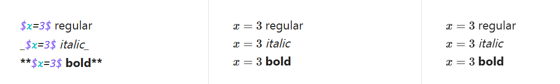

How do you mean “render”? With the examples you gave, default Obsidian renders the math and the markdown text, but it doesn’t render your markdown formatting on the math.
Example shown in Source mode, Live Preview, and Reading:
The math is identical in each.
So I assume you mean that for your examples, GitHub either doesn’t render the math at all, doesn’t render the markdown text, or doesn’t format the markdown text.
You can fix all those by separating your syntax (or simply not mixing them).
