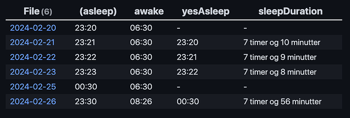

Oh well, here is a query where each daily note has two properties. awake in the form HH:mm denoting when you woke this particular day, and asleep in the same format when you went to sleep. So asleep - awake would give you how many hour you’ve not slept that particular day.
But with the following query, which assumes just the YYYY-MM-DD format, but could easily be adjusted to allow for other variants:
```dataview
TABLE asleep as "(asleep)", awake, yesAsleep, sleepDuration
WHERE file.folder = this.file.folder
  AND file != this.file
FLATTEN file.day - dur("1 day") as yesDay
FLATTEN link(string(yesDay)).asleep as yesAsleep
FLATTEN date(file.day + "T" + awake) - date(choice(yesAsleep[0] = "0", file.day, yesDay) + "T" + yesAsleep) as sleepDuration
SORT file.day
I got the following output from my test vault:
(And todays Norwegian lesson is that time(r) is hour(s) and minutt(er) is minute(s))
Note that if the asleep is set to something with a 0 as the first character, it’s assumed to be the current day, and not yesterday. This allows you to go to sleep from 10:00 today until 09:59 the following day… That should suffice for most people, even those with slightly off sleeping schedules! :smiley:
