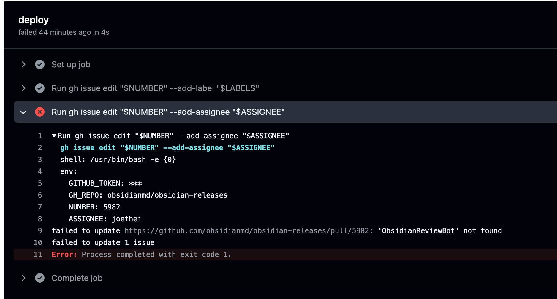

Skip ObsidianReviewBot in the PR for adding plugins, but the workflow reported an error
I’ve skipped the issues reported by ObsidianReviewBot due to some reason, but received an error from the workflow. It seems to try to add the assignee to joethei but has failed because ObsidianReviewBot could not be found. I don’t know why.
The PR number is 5982.
@joethei, could you help take a look?

We are aware of this specific issue. Your plugin will be reviewed.
