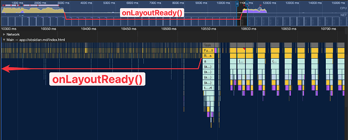

With Obsidian 1.6.0 on macOS and only a single plugin trganda/obsidian-attachment-management enabled, I am experiencing a very long delay (15-20s) before the file explorer tree on the left is shown. Until then, the panel appears completely blank, like this:

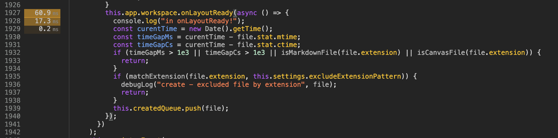

I had a quick glance at the source but didn’t see anything in the onload() methods that should cause such a delay. And this is new in 1.6.0.
I reported the issue over there already but in case this is just a regression in Obsidian itself, I wanted to post here too. Anyone else seeing this?
