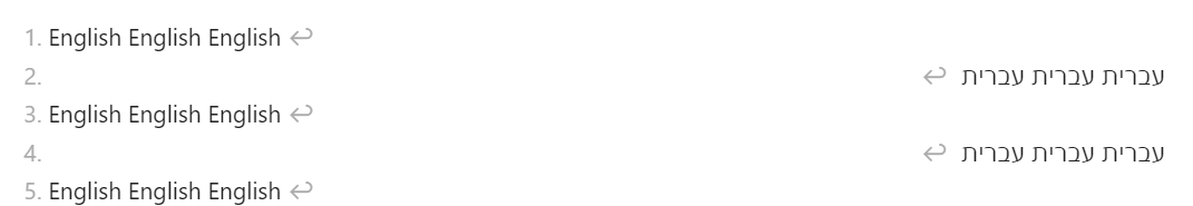

I write sources from both English and Hebrew sources and I reference them in my footnotes. The problem is that the footnotes that begin with an English word begin on the left side of the page and the footnotes that begin with a Hebrew word begin on the right side of the page, which looks a bit stupid. I want all of my footnotes to begin from the left side (as I mostly write in English). This is what it looks like now:

I asked ChatGPT and it told me to create a css file with the following:
.markdown-preview-view .footnotes,
.markdown-preview-view .footnotes ol,
.markdown-preview-view .footnotes li,
.markdown-preview-view .footnotes li p {
    text-align: left !important;
    direction: ltr !important;
    unicode-bidi: embed !important;
.markdown-preview-view .footnotes li {
I tried it and it worked.
